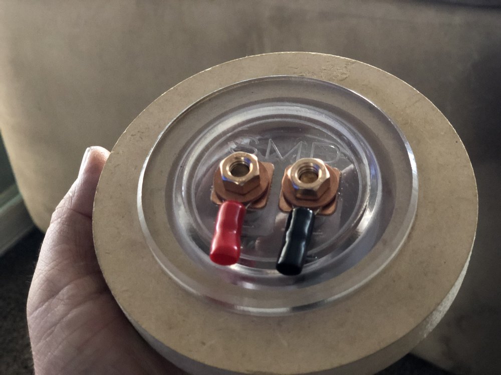

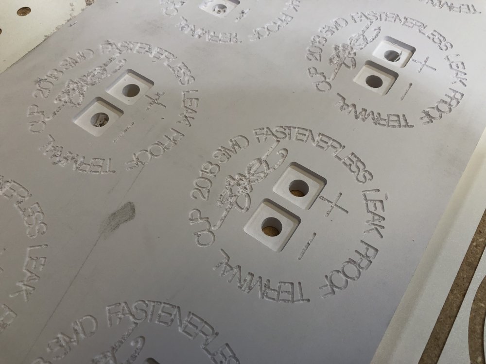

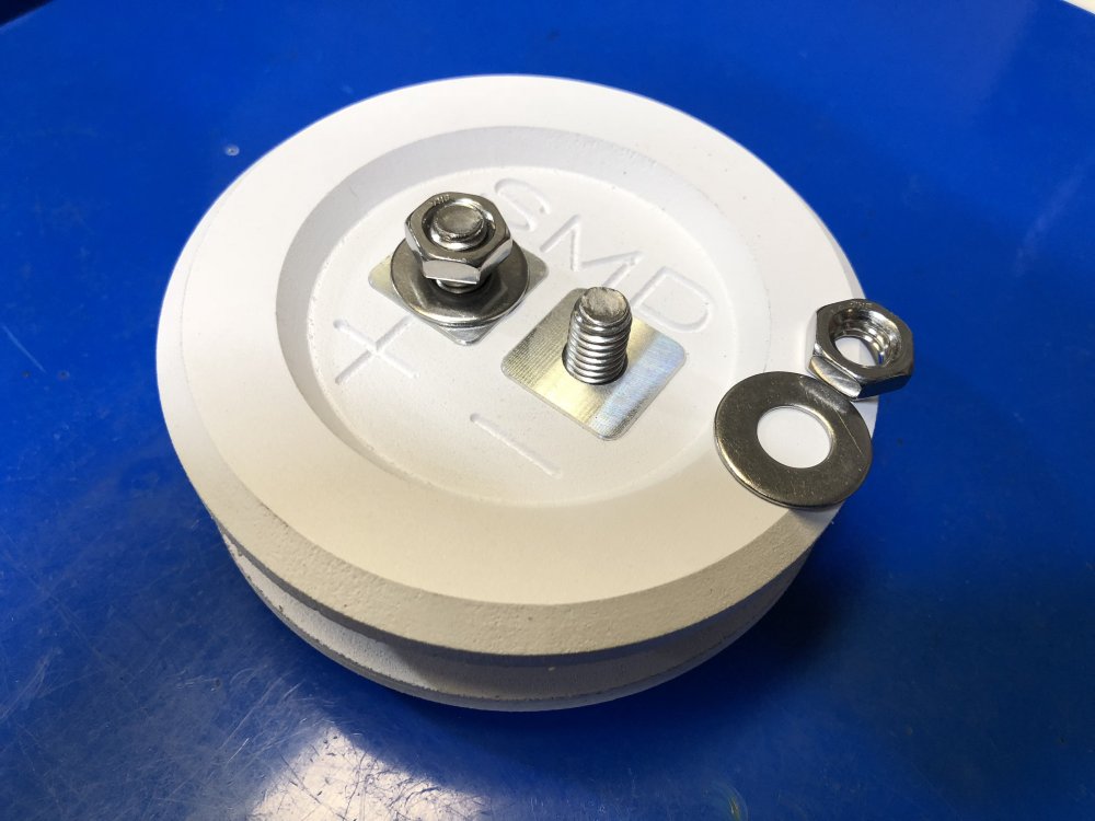

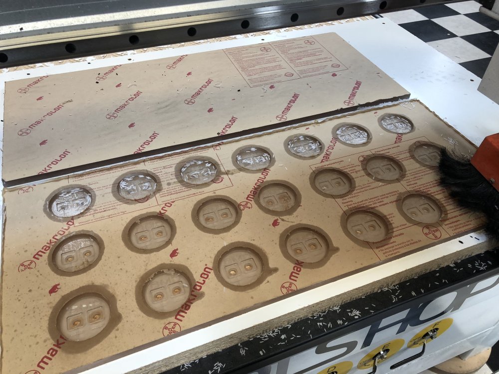

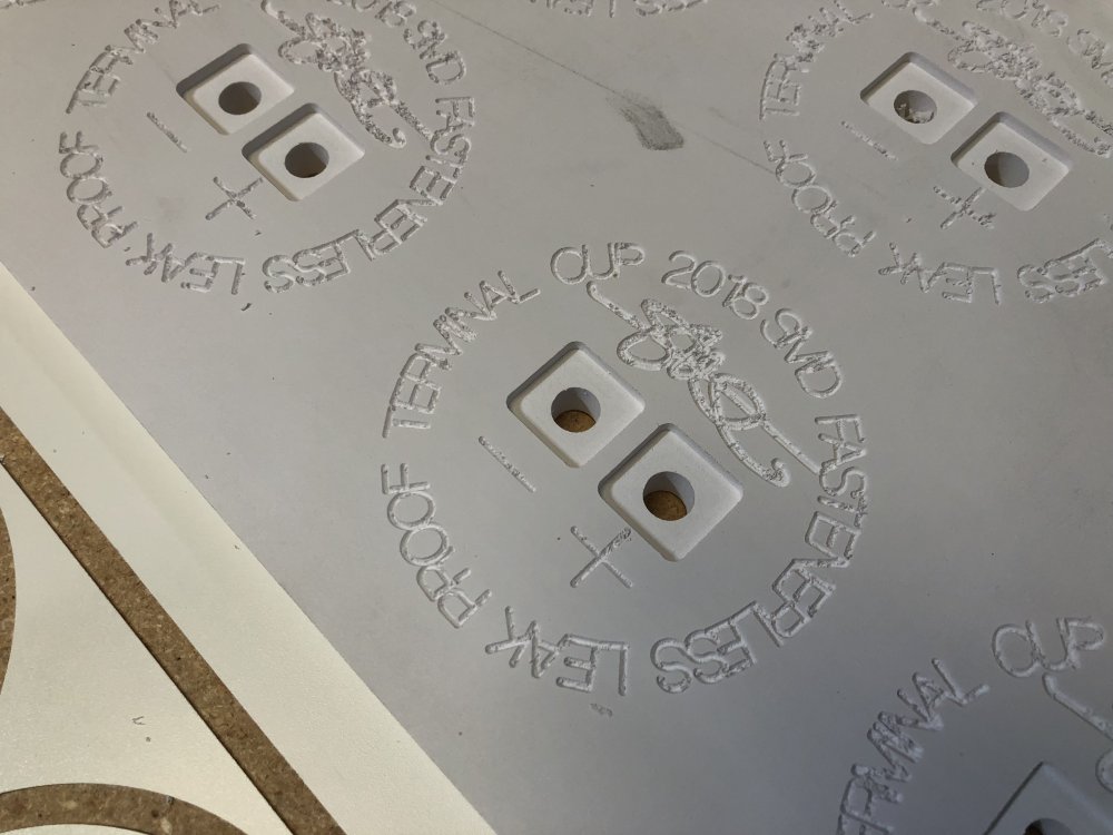

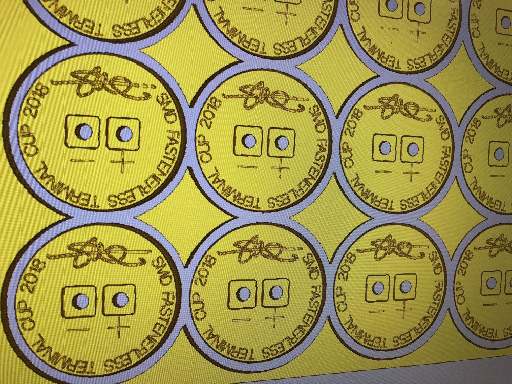

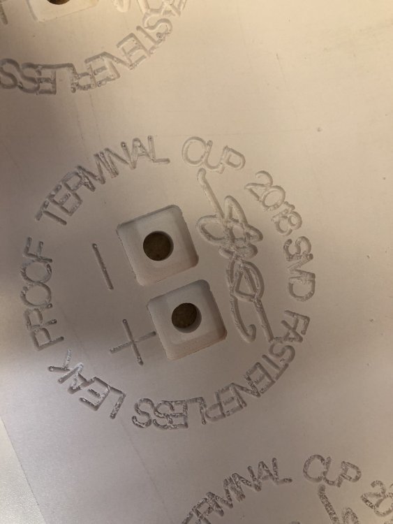

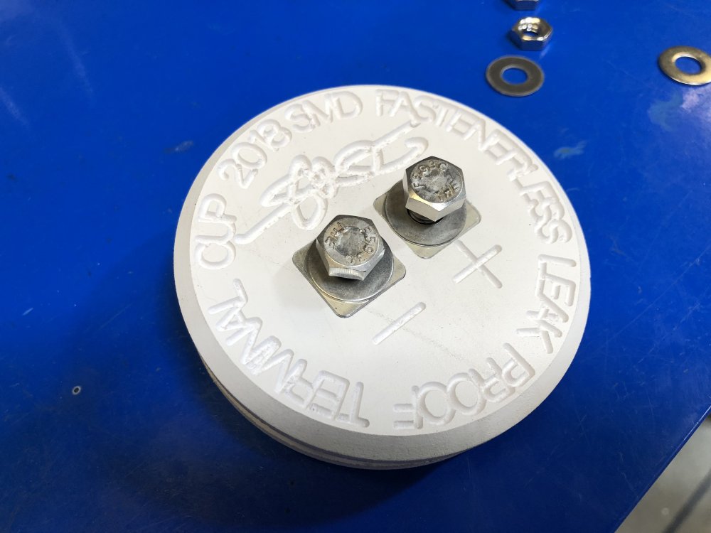

I have been playing around with this concept for months. Just now got halfway caught up from a VERY busy year. It is hard to create new stuff when your cnc machines are runnning non stop making products you already have. No complaints though! So here it is. Not for sale yet i still want to perfect them a little more. Plus, acrylic is hard to clean up once you mill it. It takes a lot of effort. They will be available in black pvc first because i can make those look perfect a lot easier.

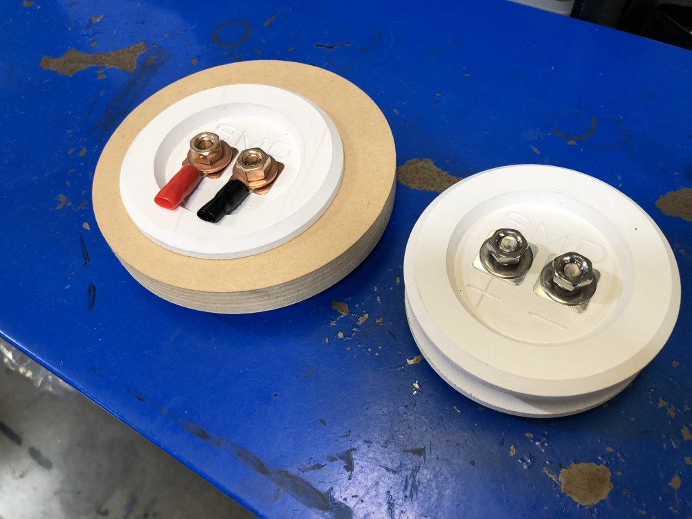

I need a practice box....hmmm...hey look there is one now under the bench! LOL

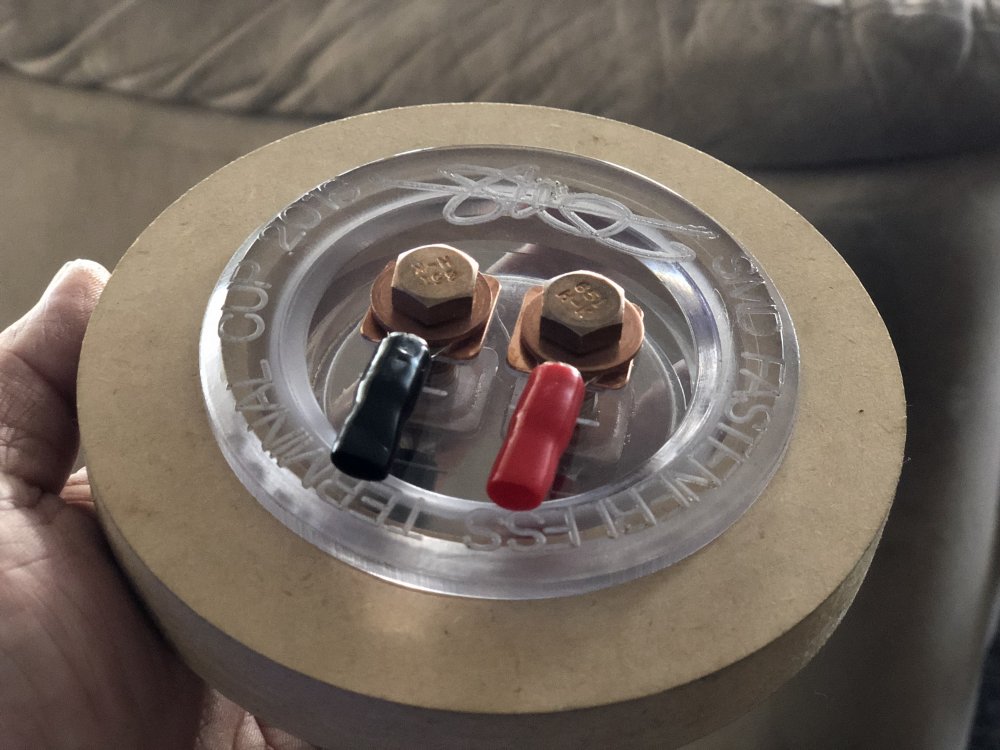

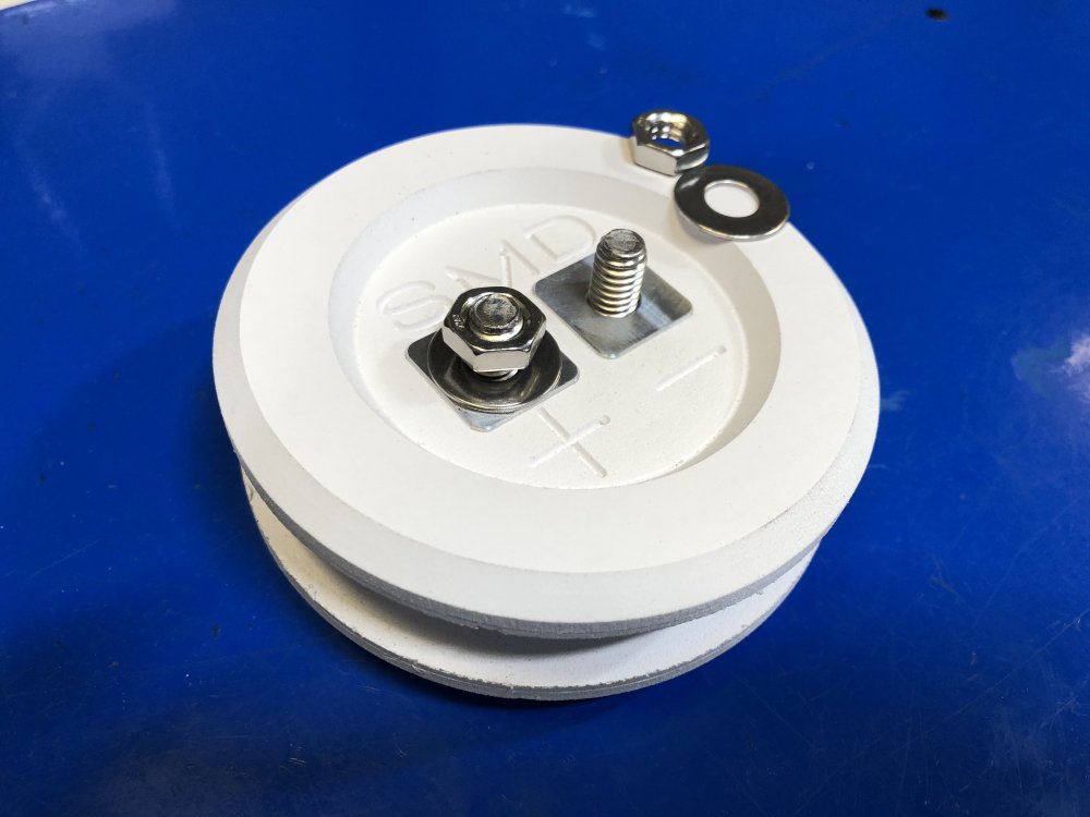

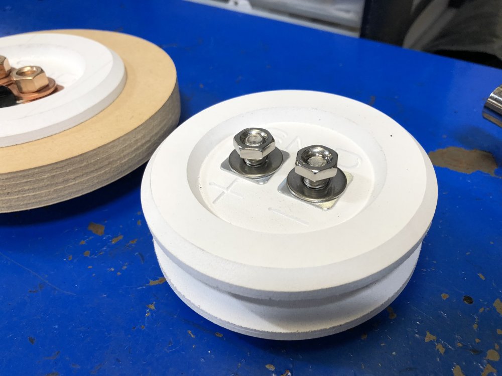

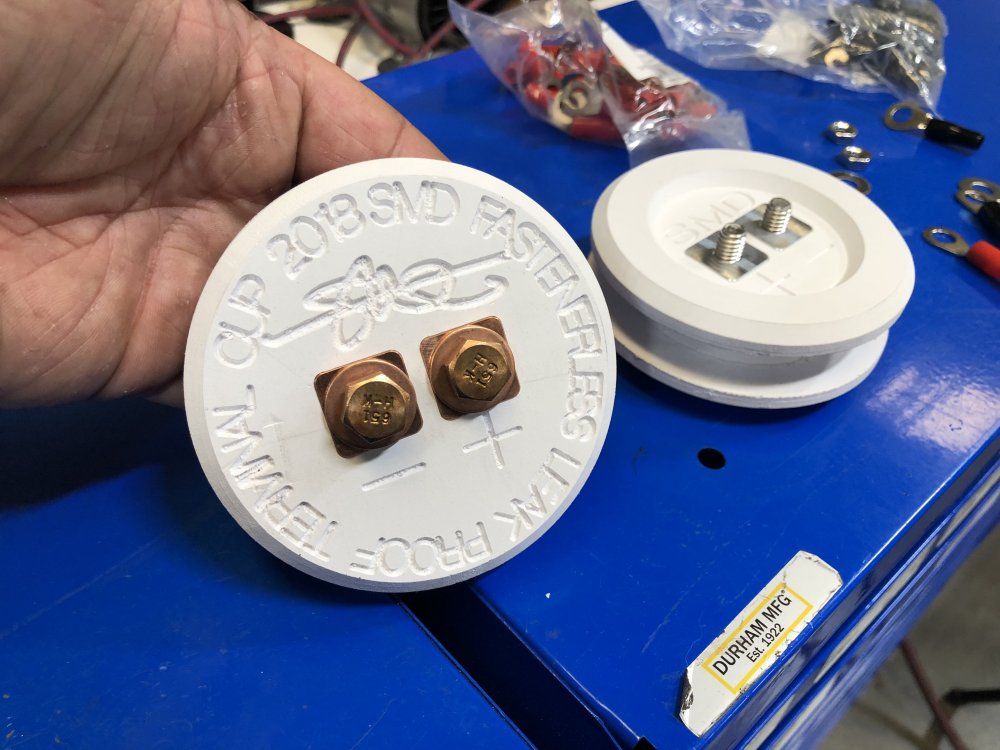

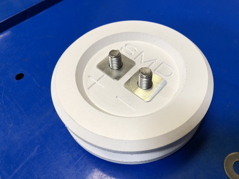

again, yes, i know the bolts are too short.  I ordered longer ones and i will also have different lengths available for different wall thicknesses.

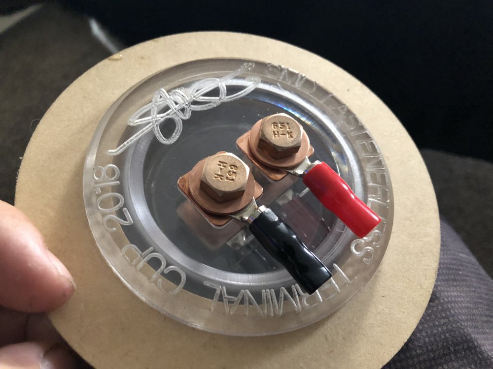

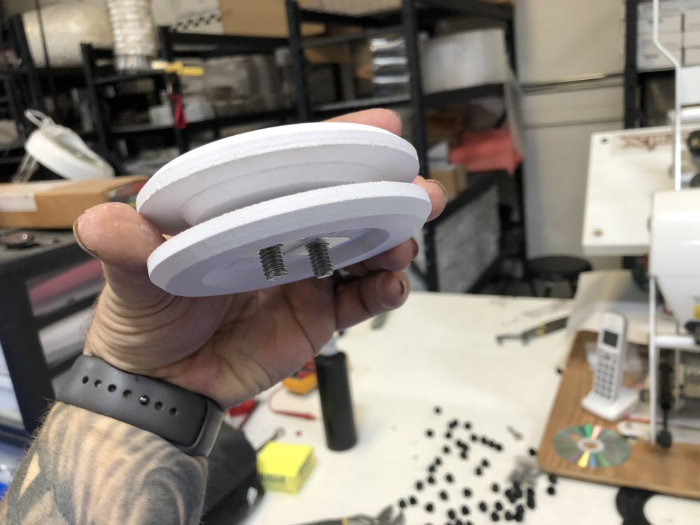

these are proto's so far.  I plan on making them amazing before they are released.

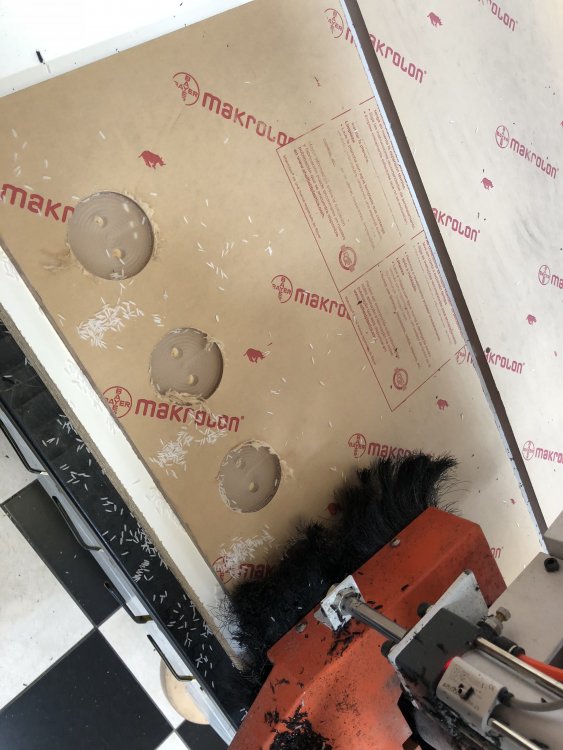

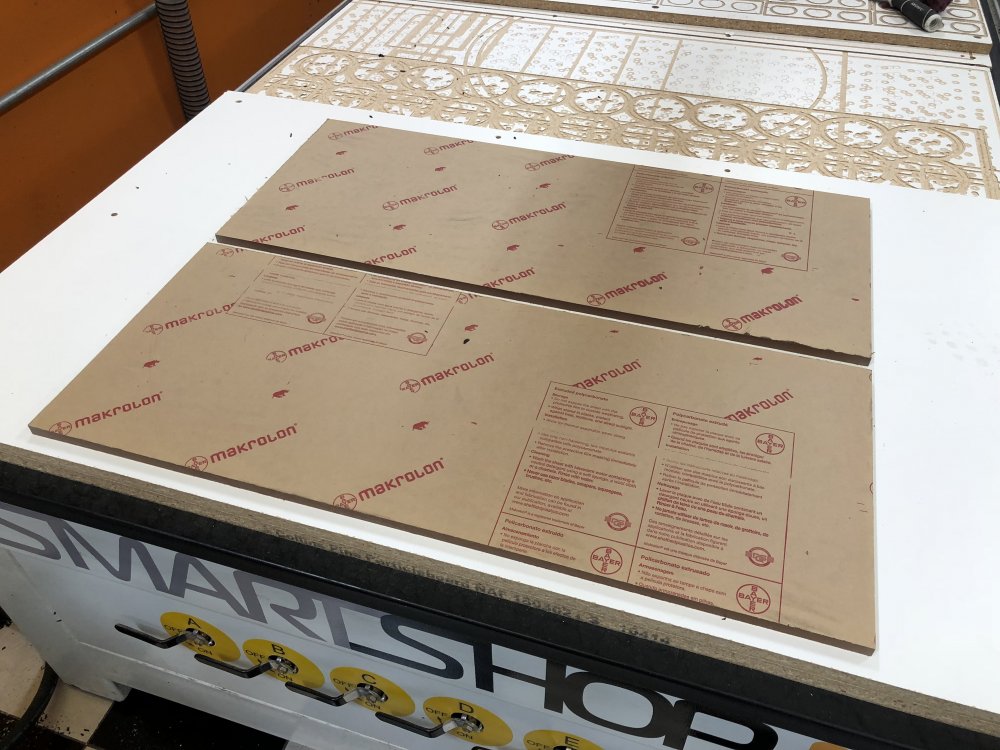

The acrylic looks nice but don't for one minute think it came out of the machine that way. I sanded it for 20 minutes and flame polished it for another few minutes.  I ruined the first one.  Getting tool marks out of milled acrylic and making it perfect is very time consuming.  Therefore, i shall make them out of PVC too. Easier to finish and make look nice :D
