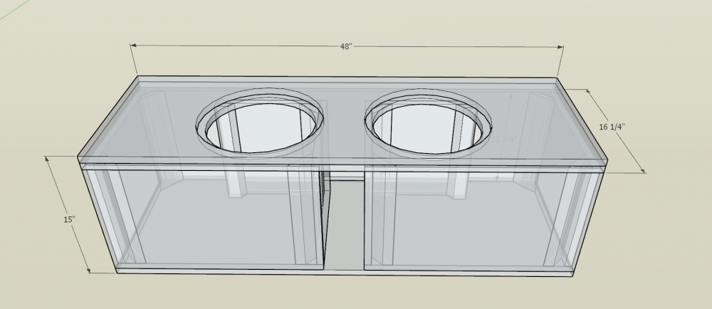

Enclosure design for 2 Sundown SA 12s for a Tahoe
CONKLE73

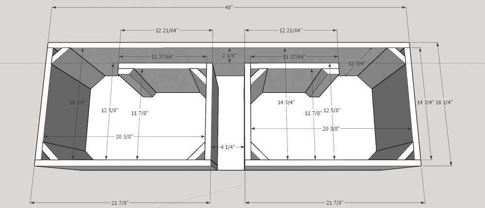

15x48x16.25 =Vb [email protected]
Port- 12.75x4.25x25
2x top baffle
.28 woofer displacement
.10 bracing 45's
2 common Port wall
.75 baffle and material thickness
54.19 port area
14.33 per ft
Should sound really good imo. I've had personal experience with these woofers.
3 hours ago, DiBo said:
Dude that's perfect!! Round over the port ends tho. Other than that, looks great!
Sweet!
I'll post picks when I get it built...
Thanks again!
