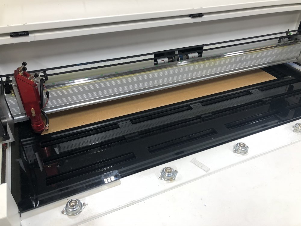

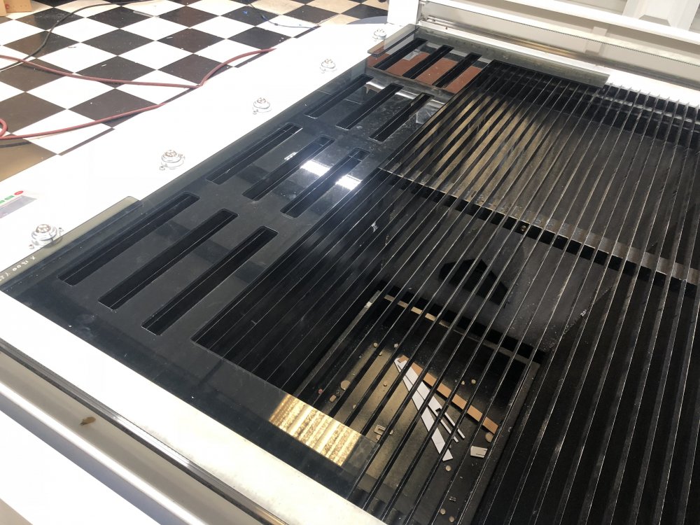

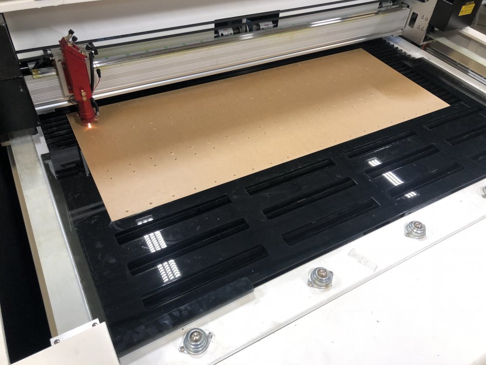

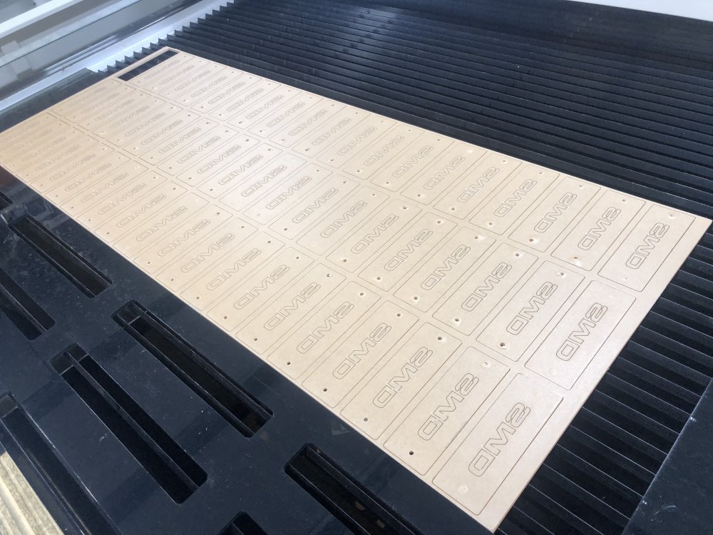

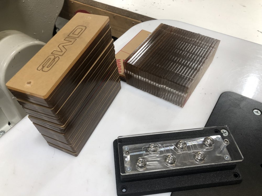

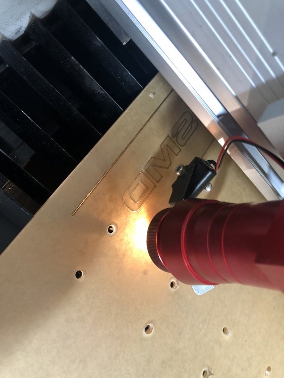

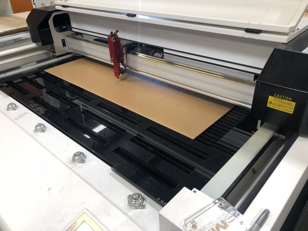

i had to make this jig in order to put my project into its correct spot.  I can cut anything i want on any part of the table, it's just a matter of setting your origin point.  But for the projects i make, they are coming off the other table and have to be in a specific spot.  I have to be able to start the laser EXACTLY on the corner of this project and it has to be 100% parallel to the laser's travel (X) in order to hit the proper spot on the project.   I have a video going up you can see what i am talking about...kinda.
