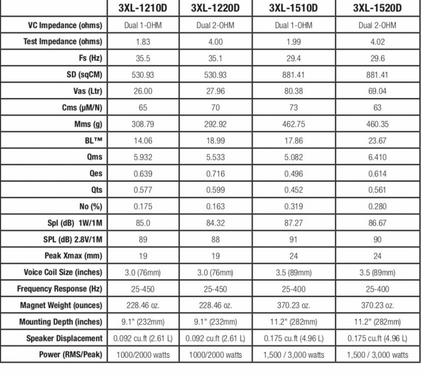

Hi there, urgently need help designing a box for two powerbass 3xl. These are the 1510D version. They'll be hooked up to two sound magus VS3500s and will be receiving about 2kw rms each. These are going into a 96 Toyota 4runner. Looking for a box design optimized for spl. Attached are some parameters of the subs. Any help would be appreciated. Thank you

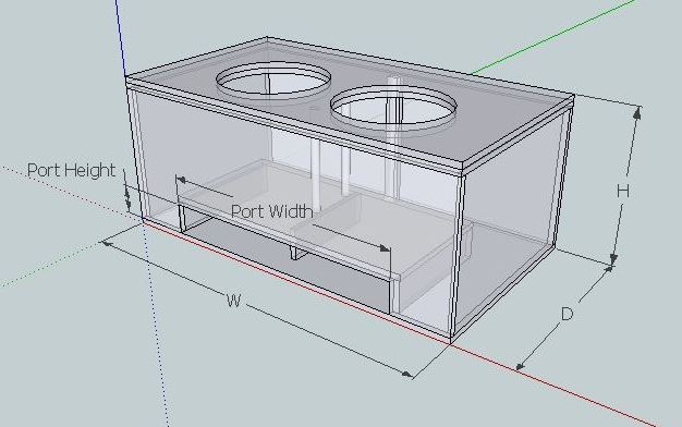

So here is a suggestion for daily on the louder side, power: to subs rated, amp subsonic filter to 28Hz, minimum port clearance 5", figure is just an assembly guide:
