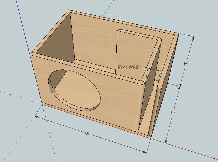

Would anyone be able to help with a box design.   Going to be for a home sub box.   Sundown E-15 V3 D2 with 500 watts.   Recommended (Sundown) ported box is 3.25 ft^3 with 52 in^2 port area for 32hz tunning.    Don't mind doing slotted or PVC pipe, whatever is best.
Thanks!
Home sub box, all types of music/movies.   Size doesn't matter, but would like it to be square if possible.   For example, 18x18x22.     I was leaning more towards a slotted port, as I believe it would be easier for me to build.   Just a bit confused on getting the right port size.

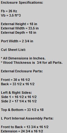

So here is a suggestion, power: to sub rated, minimum port clearance 2 3/4", figure is just an assembly guide:

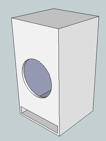

When finished let it stand on a side, will look like this:
Hi Joe X,
   Does it matter where I place the sub?  Was going to place it closer to the port.   Would that work, or should i go directly center of the box?
