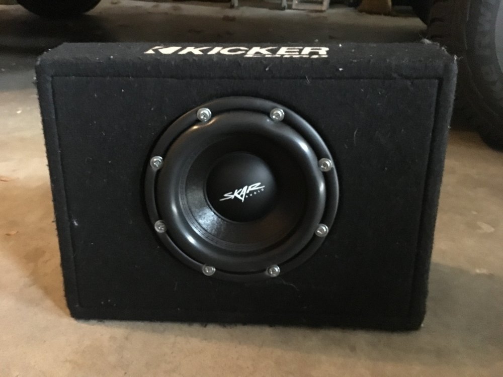

I bought an old kicker comp box for  another use that didnt work out, so I put the skar in the that and it really likes a  vented box, things  are feeling good
