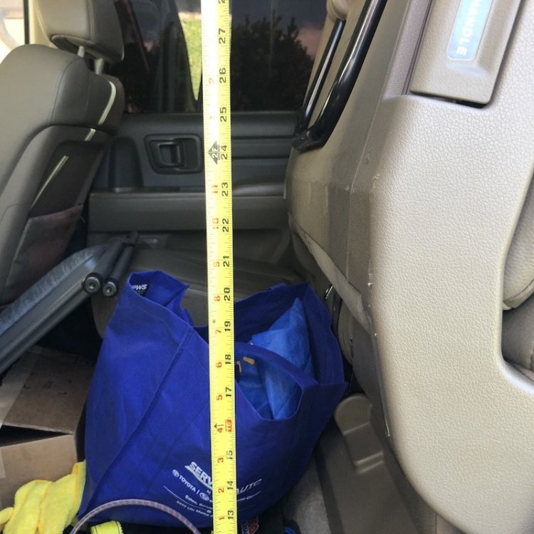

Box will be behind my driver seat with the rear seat folded up. I have measured it out to 33" x 21"x24" (WxHxD) I added pictures to help illustrate the space. I can adjust the box to fit between the seats higher but the depth will need to get lower as it gets higher.

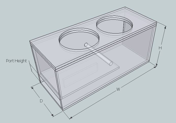

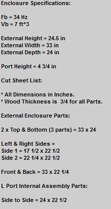

So here is a suggestion, power: to subs rated, amp subsonic filter to 28Hz, minimum port clearance 4 3/4", figure is just an assembly guide:
NOTE: notice the port brace in the figure below.
