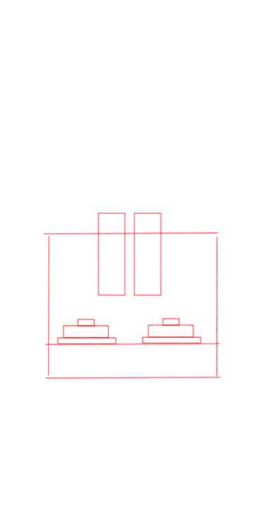

Ayork Posted February 3, 2019 Report Posted February 3, 2019 I been woundering if the location i have the ports for the 4th bp could cause unloading or some other issue? It sounds great, but when turning the volume to where i set the gains on the amp to (conservatively), im getting some distortion or some knida odd noise. Attached a sketch of the box. Gains set useing -5db test tones and headunit was no distortion. 2 12" skar evl, skar rp1200.1 Top chamber is ~3.5cu ; bottom is ~1.8cu Ports: 2 4"x15.3"
Triticum Agricolam Posted February 3, 2019 Report Posted February 3, 2019 Ok, so there are two BIG problems with your ports. The first is that you are tuned way too low. For a bandpass box you should be tuned somewhere between 40-50 Hz, you are tuned to around 32 Hz. The second problem, and this is probably what you are hearing, is you have way, WAY too little port area. Your two 4" ports have about 25 sq in of port area, based on the specs of your box and the power you are running you should have more like 60 sq in of port area. "Nothing prevents people from knowing the truth more than the belief they already know it.""Making bass is easy, making music is the hard part."Builds:
Ayork Posted February 3, 2019 Author Report Posted February 3, 2019 I also gave the gross vol to top chamber by mistake, net is ~3.2cu so the port length lines up. I really wanted to do a square port. I have bass box pro so ill figure something out. Thanks for ur input @Triticum Agricolam
Patrick Bateman Posted February 19, 2019 Report Posted February 19, 2019 On 2/2/2019 at 4:44 PM, Ayork said: I been woundering if the location i have the ports for the 4th bp could cause unloading or some other issue? It sounds great, but when turning the volume to where i set the gains on the amp to (conservatively), im getting some distortion or some knida odd noise. Attached a sketch of the box. Gains set useing -5db test tones and headunit was no distortion. 2 12" skar evl, skar rp1200.1 Top chamber is ~3.5cu ; bottom is ~1.8cu Ports: 2 4"x15.3" Where did the box design come from? 5.3 cubic feet is a LOT for two twelves, and bandpass boxes typically have a large back chamber and a small front chamber. Your box is backwards, with a large front chamber and a small back chamber. Here's the predicted response. Basically one-note-wonder. Here's the excursion, with 1200 watts into a 4ohm load.
Ayork Posted March 1, 2019 Author Report Posted March 1, 2019 Thanks, i designed it from stuff online about 4th order BP and what would fit the space. Ive aslo retuned it to 40hz. I tried hornresp and was just confused on how to use it. I modeled it in bassbox pro before building. I can post the graphs if you wanna see or not.
