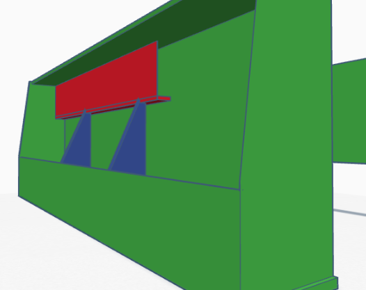

thefatkid Posted April 1, 2019 Report Posted April 1, 2019 alright so ive read and read till my brain hurts, i have a better understanding of ports i believe heres where i think im at on a final design barring any negative feedback on what im going with. 4 sundown e3 10s, 64 in ^2 of port area tuned to 32hz as recommended, 4 cubic ft after all displacements port is going to be 4" x 16" x 27.5" long to stay under the 1:6 port ratio 4 subs facing front but port exit is my quesiton here. i know normally people port to side but ill have to port up is there anything im not accounting for doing my port this way vs out the side. i cannot port to the side due to the box needing to touch wall to wall. seems its as simple as moving the cut out on top vs the side. thank you all in advance this forum has been a huge help and there is a wealth of knowledge here if you take time to dig around. Josh T>
ckeeler11 Posted April 3, 2019 Report Posted April 3, 2019 How will the port run inside the enclosure if coming out of the top? From the drawing it looks like it will be right on top of the subs?
thefatkid Posted April 3, 2019 Author Report Posted April 3, 2019 correct running down the width of the box
thefatkid Posted April 3, 2019 Author Report Posted April 3, 2019 oh i see, not right on top thats not to scale at all, just showing port oreintation compared to sub direction etc.
