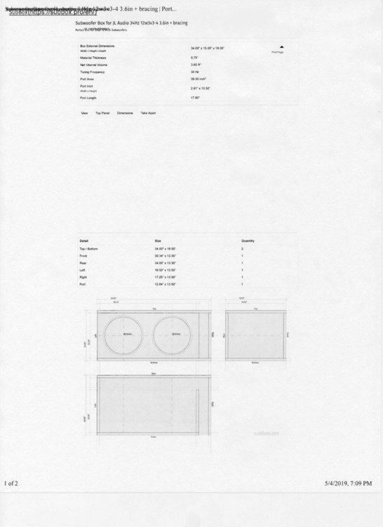

Oldschoolconcord532 Posted May 5, 2019 Report Posted May 5, 2019 I'm trying to build a ported box for my 2017 Legacy. I currently have 2 JL Audio 12W3v3-4's being ran by JL Audio XD700/5v2. I know that I don't have a ton of power running my subs but I wanted a system that was easy to install with good sound. I will be upgrading to the XD1000/5v2 just to give me more power to the subs. Below is the box that I have built but it just doesn't give me that deep bass that I'm looking for. The bass sounds OK but it really lacks that low bass. Can someone tell me what I can do to get better sound.
