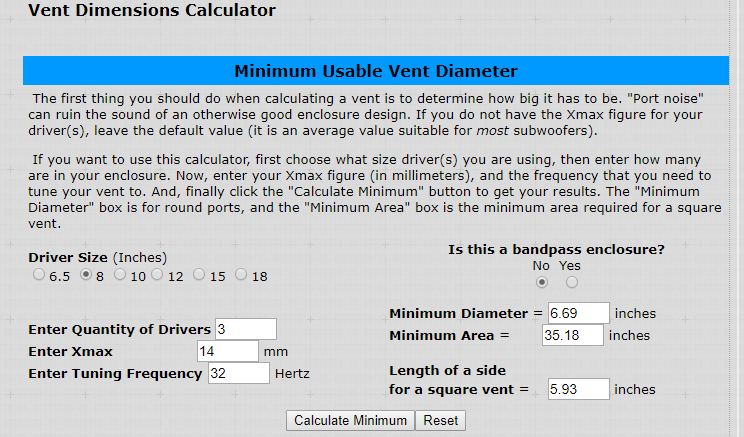

Triticum Agricolam Posted May 24, 2019 Report Posted May 24, 2019 1 minute ago, aburger said: Sorry, I'm so confused. Why do all the port calculators say I only need one or two aero ports. For instance, I used the calculator at http://www.decibelcar.com/apps/108-slotcalc.html and it says for an enclosure volume of 2.25, tuned to 32 Hz, I can use (2) 3" round ports with a length of 14.34" each. Are these calculators incorrect, or am I just reading this wrong? Sorry again for all the Noob questions. So that tuning calculator you listed is correct, you could use two 3" round ports 14.34" long and that would tune your box to around 32 Hz. The problem is while two 3" ports will give you the tuning you want, they aren't going to be enough port area and you will have issues because of that. If you look at the Minimum Usable Vent Diameter calculator at the top of the page and put in the info for your setup, it tells you you need about 35 sq in of port area. Here is a screen shot: I will warn you though, the formulas used to develop that particular port area calculator are based on work that was done over 30 years ago and it isn't always reliable with modern subs. To properly determine how much port area you need you have to take input power into account as well. In this case the calculator above was very close to what Sundown and I were recommending, but that isn't always the case. I've developed my own port area calculator that does a better job IMHO. You can see it here: https://goo.gl/STAv4p "Nothing prevents people from knowing the truth more than the belief they already know it.""Making bass is easy, making music is the hard part."Builds:
