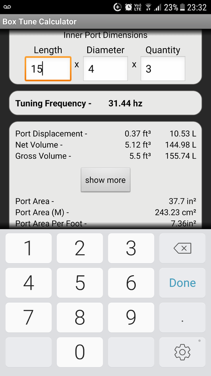

Heya guys. I have 2 rockford fosgate p2 d4-15's running about 1000 rms at 1 ohm. ( i know its a little over rated for these subs but ive lowered the gain to compensate.)
the box is as follows:Screenshot_20190620-233211.thumb.png.55455f0407a956e7b8f7551c3fe2e10c.png
The box is sitting in the boot of a seat altea. Its an mpv. Subs facing window screen, ports firing up to roof. Box is
34" wide x 20"tall x 17.5" deep.
Any advice to make this box better would be much appreciated. If you need more info let me know guys.
I tried modeling it in WINisd and it came out with a peak at 50hz.
However running frequencies in the car shows a peak more between 36hz and 45hz.

Would like to know where im at roughly with tuning.
Specs ive built the box too say 31.4hz
however in the car im getting roughly 38-43 ( going off my ears running frequencies on a tone generator)
Wondering if i messed up the box and port tuning or if its due to cabin gain.
Would like my loudest notes in the low 30s.
Hope this makes sense.

How much can you realistically over size a ported sub box ? ( i feel 5.5 ft3 is a little small for 2 15's on 1000rms trying to hit 31hz)
Would a bigger box help get louder lower ? ( like a 6ft3 box or 6.5ft3)

How much can you realistically over size a ported sub box ? ( i feel 5.5 ft3 is a little small for 2 15's on 1000rms trying to hit 31hz) - Increasing box size will increase cone excursion, just how far you can go depends on how much power you are running.  Those RF subs would probably benefit from a little bigger box.
Would a bigger box help get louder lower ? ( like a 6ft3 box or 6.5ft3) - Yes, it would, as long as the increase in box volume was reasonable.  The bigger the box, the more output you get around the tuning frequency.

Your tuning may be ~31 Hz, enclosures don't always have peak output at the tuning frequency.
The biggest issue you are dealing with is those particular RF subs are really meant more for a sealed box.  This is why the output rolls off below 50 Hz and why you saw such a difference when you modeled a different sub in WinISD.
