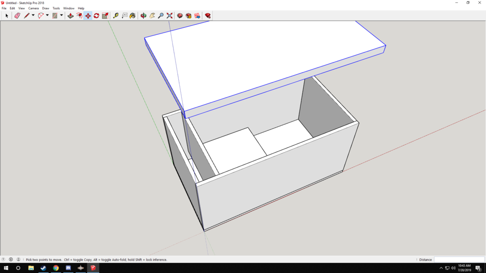

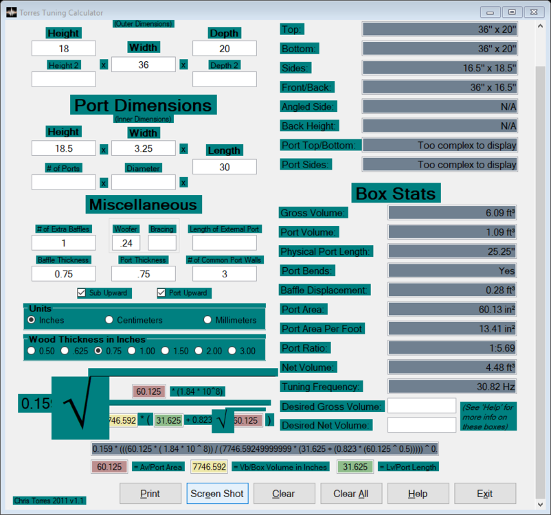

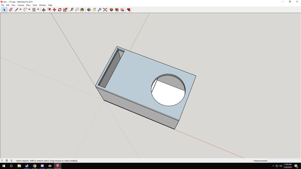

at the risk of looking like a huge dumbass, I've used my SketchUp skills (or extreme lack thereof) to kind of draw this up... I couldn't understand how the port was supposed to be built so I did a little bit of editing.  I upped the port height just a little bit, tightened the width, and cut an inch off length... that added a little bit to my net volume and dropped the tuning down to 31Hz not accounting for 45's and bracing.  Hopefully that is going to bring it up to 32-33Hz range?
This is how I should be looking, correct?  Baffle will be have a hole cut in it to sit over the port (i did take into account the extra 1.5" of port length when building it in SketchUp :D)...
Here's how my Torres is looking now.  I just want to make absolutely sure I've got all of this looking tip top and have all my measurements fully planned before I start sawing wood.
Thanks again guys.
Looks good to me. Add 45's in corners and maybe a dowel to brace the baffle and the overall cu ft will fall around 4.25
