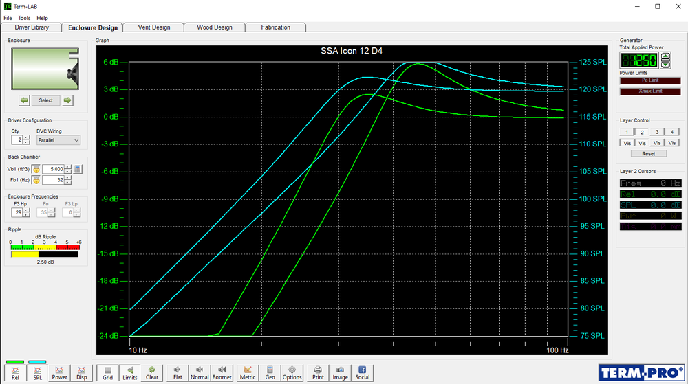

Not sure what subs or amp you are using but here is a comparison of what it would do to 2 SSA Icon's going from a 4.5 @ 42 box to a 5.0 @ 32.  (The 32hz is the lines pushed further left).  Hopefully this helps you visualize and imagine the difference in sound :)
