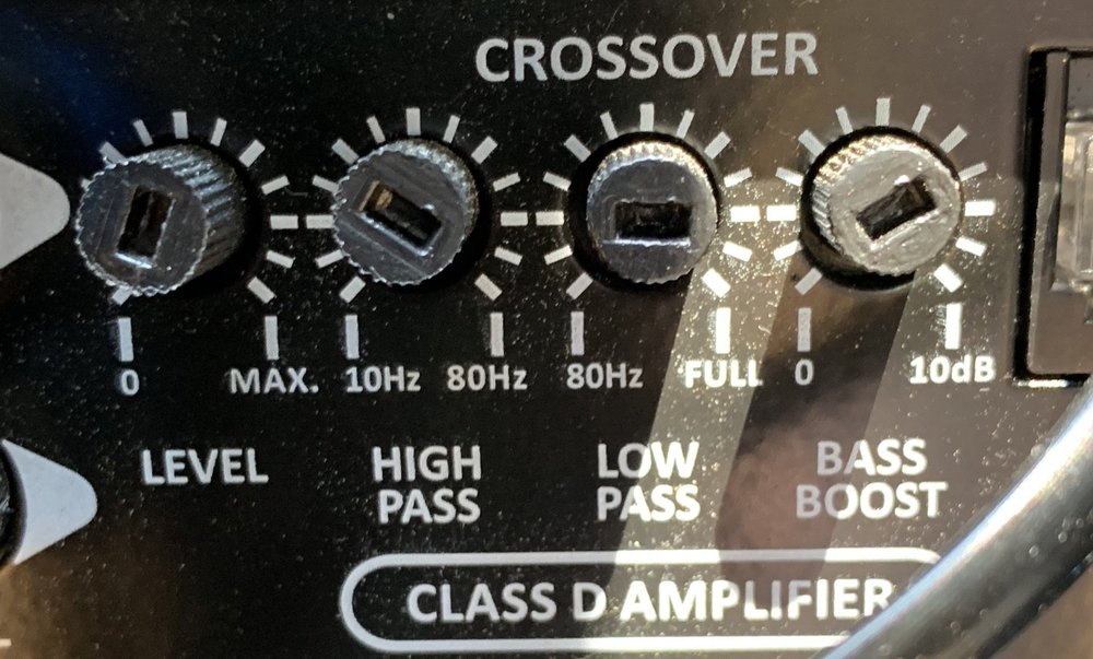

Here is the amp settings. Crossed over at the head unit at 80hz. So I’m not sure if I’m doing something wrong or what. But I do appreciate all your help.
I, personally, would turn off the LPF on the radio and use the one on the amp only.  Try dialing back the high pass a bit and see if you pick up some output below 35hz, it looks like its set to ~27.5ish unless you have it cranked all the way clockwise??
I wouldnt set it to 10 but maybe set it to "25" or "20" and see if you pick some output up around 30.  Maybe the scale on the face of the amp there just isnt 100% accurate.
