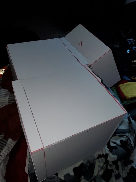

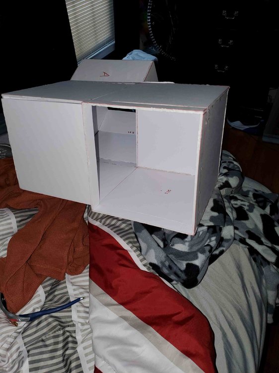

Would this port I put together work? Measured down the middle it is 27 inches long. But the port openings are close together. I'm afraid it wont operate as if it were 27 inches long. So will it work as intended as long as the length is correct or will this shape be a hindrance?
Yeah that probably won't work.  You can look from one end through to the other.  Its probably going to act like its a lot shorter port than you intend.
