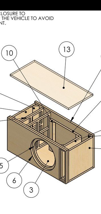

Daveey Posted January 10, 2020 Report Posted January 10, 2020 Hey guys I'm new to car audio, I have a single sundown sa 12 in a ported box I built. It is powered by a sundown sae 1000d with 1/0wire. I built my fist box on my own and it's not the greatest, it doesn't sound horrible but just from watching videos I know the sub is not putting out anything near its potential on even 900 watts sms. I'm in the process of building a better box with some plans I found online. I have enough mdf to build 2 maybe 3 boxes. Anyway the plan is for a 2 cubic foot box tuned to 35hz ported. Sub and port facing back, I have a suv and have read that sub up port back may be better for my vehicle. I plan on building the box to specs and then I also want to build another box with the sub up to test and see which I like better. My question is can I just put the sub cut out in the top panel facing the sub up and leave the port location and dimensions the same? Or do I need to change the port location in the box if the sub is up? Here is the plan I have. Please bear with me this is all new to me.
AaronT Posted January 10, 2020 Report Posted January 10, 2020 A port is a port . A mounting hole is a mounting hole Yes your idea is perfectly fine. Think about it how else would you face port back and sub up?
Daveey Posted January 10, 2020 Author Report Posted January 10, 2020 I didn't know if the port would need to connect to a different wall in the box or change in some way based on the subs orientation. Sorry I'm new to this.
