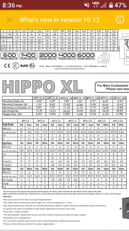

Trying to build a box for a Charger trunk. 2- 15” hippoxl. The build sheet they give out does not really match what the cubic ft for ported box should be. The subs require 4.75 cubic ft each, yet in the dual ported box are saying 6.03 cubic ft together? Not sure how that math works out. Any help is appreciated.
CAR: 2006 Charger SRT8
SUBS: HIPPOXL 152R

Think u are misreading somewhere or looking at a different model on accident. 9.5 cubes optimal for 2 and 7.8 cubes small for 2
HIPPOXL_R_Manual_V2.pdf
