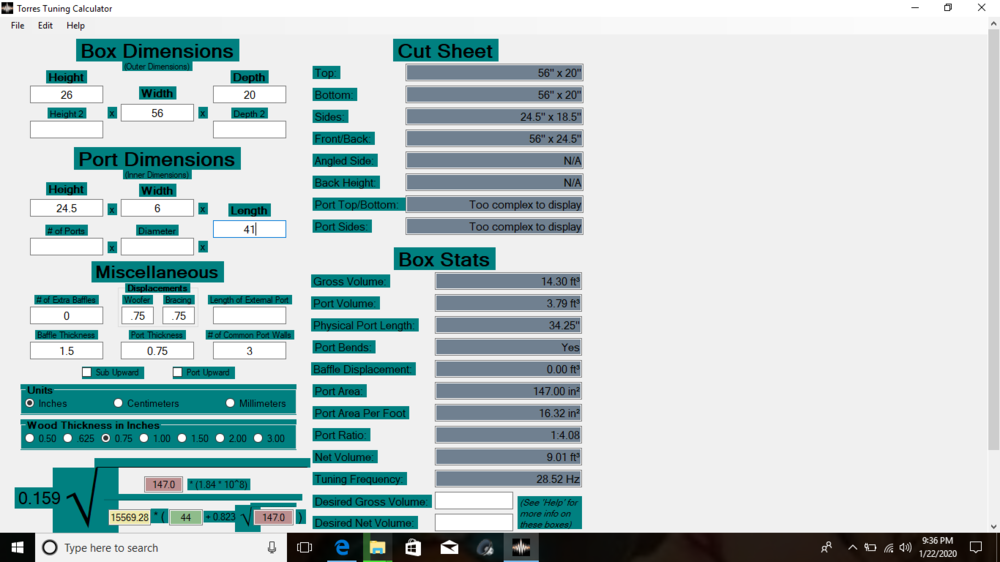

Just need someine with more knowledge than me to take a look at my Torres results before I start cutting please. Also can I use both Baltic Birch and mdf in same enclosure? Like on a baffle glue the two together? Thanx in advance.52063561_Screenshot(33).thumb.png.41c3e5f7755eabb4b8b00255974f32c7.png
2 hours ago, strangeduck said:
So you are doing a 3" thick baffle?
No, just a double layer 1.5" ( would like to use a layer of Birch and a layer of mdf sammiched together.
Awesome ty, didn't even see that! Other than that the numbers look ok ? I know it'll change the volume a bit but I'll tweak and repost if u don't mind looking at it again when I correct my mistakes.
1938826753_Screenshot(36).thumb.png.ede1bf834eafa402940ad7fdb2e5d0d6.pnghere is revised torres screenshot, thanks for catching my f-ups! Also saw I had the port hiegth wrong, at 18.5 tall total box height would have been 20 not 26 ...too many numbers to tweak and sometimes you don't catch all the mess ups that's why I ask here for ppl to proof it so its not an expensive mistake. I appreciate it!

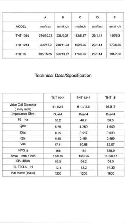

3 15" AB TNT ( new style 1500rms/3k max) on 3k , wired to .66 ohms   I used the port calculator ( triticums calculator) for power level and 28hz says I need 126in2 total port area . Closest I could get was 147in2.  Only question I have is the tuning, fs of sub is 38.3, they play 28hz no issues right now ( 2 in a too small prefab with not enuff port area and too high of tuning, bought the box for my gf truck but am using it till I can get my box built, can't ride without some bass) just not with great authority , but I'm blaming the box they are in right now.Screenshot_20200122-221437.thumb.png.ffaf12882c2f16dae4f402b6552520ae.png
thats about the same cone area as my 4 12's build on 3k. i had 129sq in of port tuned to 32hz. i was at about 9cuft.
that said, i think you are close enough to build and see what happens. looks like you have more than enough port area but the port is a bit long in my opinion but that may not matter. i like to keep my ports under 36" long. i have no logical reason for that though.
I would see who else chimes in first though. maybe tag triticum and joeX . they are both pretty knowledgeable
