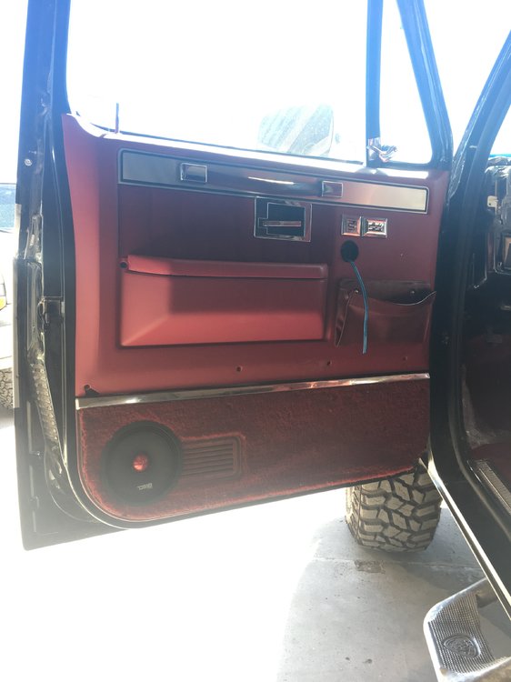

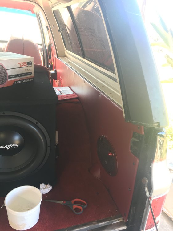

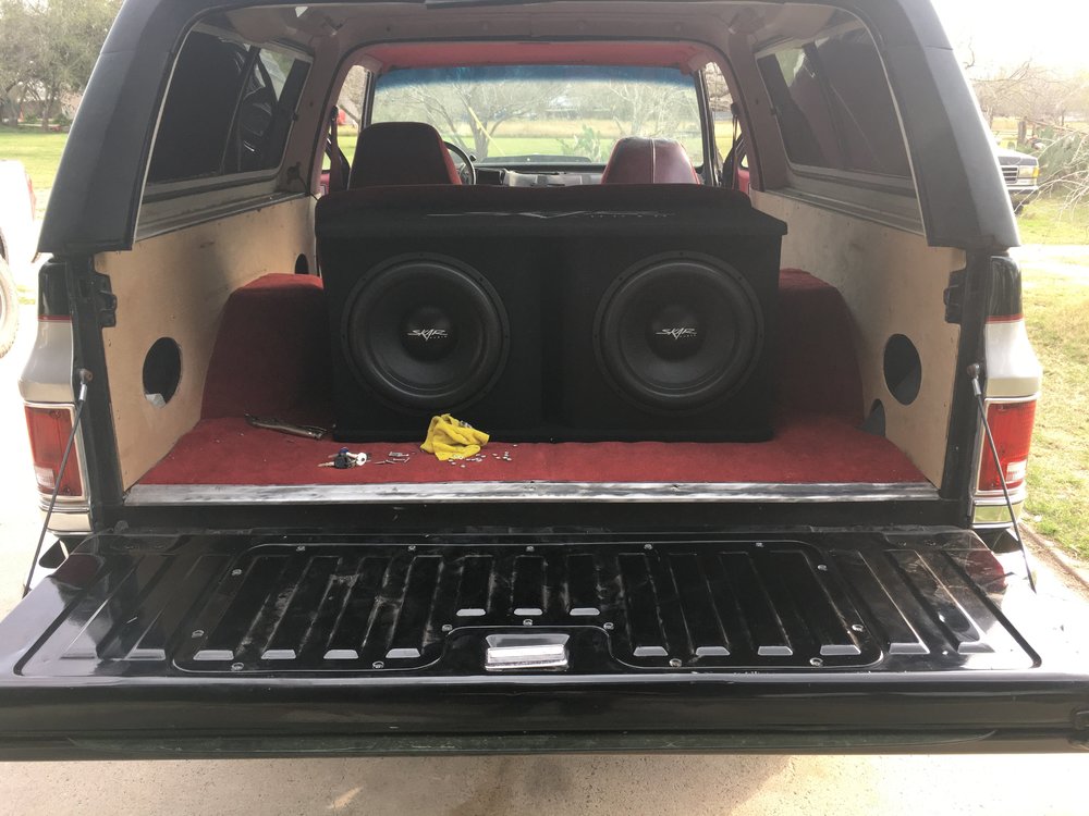

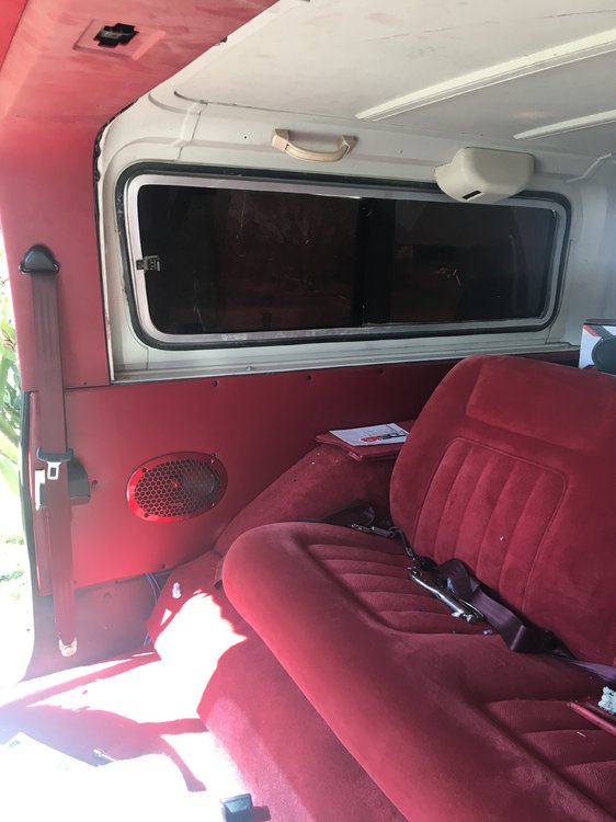

So i have a 91 K5 blazer that i just installed all new wiring and speakers new head unit amps and subs. I even got the dd1+ and cc1 to be legit. So i plug everything up turn the truck on and no sound. Only thing playing is the subs. Then i turn the truck off and leave the key on the run position and boom i get music. I turn the truck back on to see if it work and it starts to play i hear static then the mids cut out and only thing left playing is the subs again. I swapped the RCA's and moved my ground to the head unit and still the same thing. I even tried a different head unit and i get the same results. Ran out of ideas i know it has to be something the the truck wiring but im lost in the sauce. I have a DS18 1000.4 voice amp and 2 15" Skar subs and 1500rms Skar amp.
