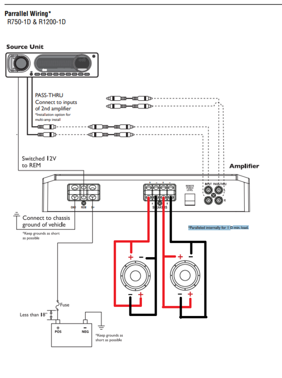

What I was going to try to use for hooking up 1 ohm is attached,

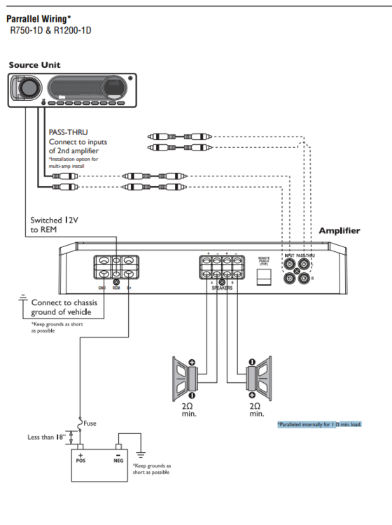

Confusing from the Manual, Do I run one wire from side one positive and side two negative? *Paralleled internally for 1 � min. load. < No idea what that means lol
hook it up exactly as you see in that second picture and you will be at 1ohm. Hook one speaker up to the Speaker A side and the other to the Speaker B side. The terminal is connected inside the amp so the + for Speaker A is the same as the + for Speaker B (and same for the - connections). You will still need to connect your voice coils in parallel at the speaker however.
It's identical to shoving 2 wires into a single terminal except it looks cleaner.
So by Parallel you mean like this picture correct?
2 minutes ago, MrSkippyJ said:
yes sir!
