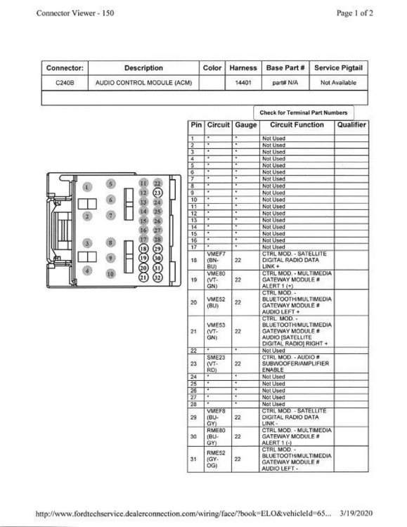

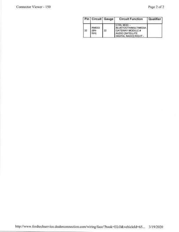

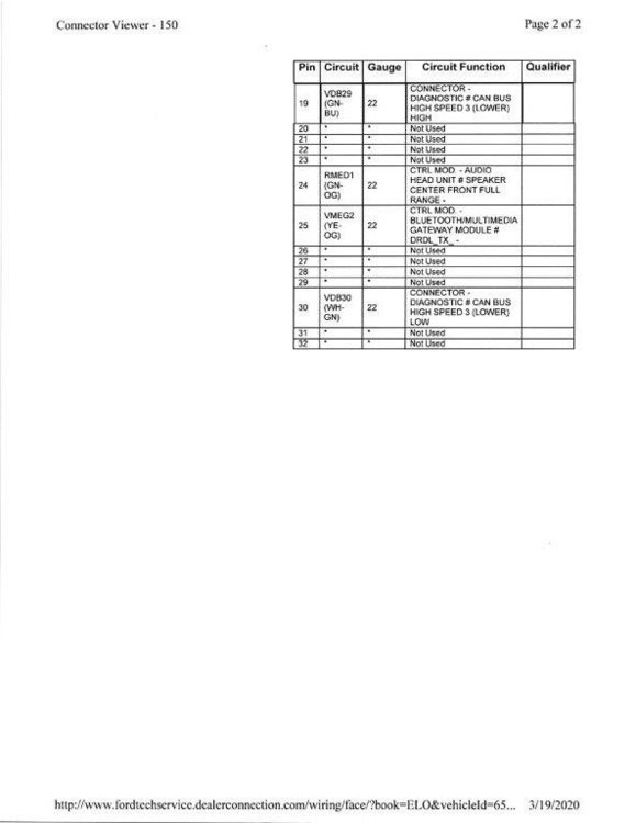

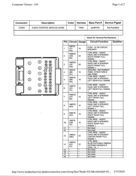

Pinout for 2020 connector incase anyone stumbles on this.

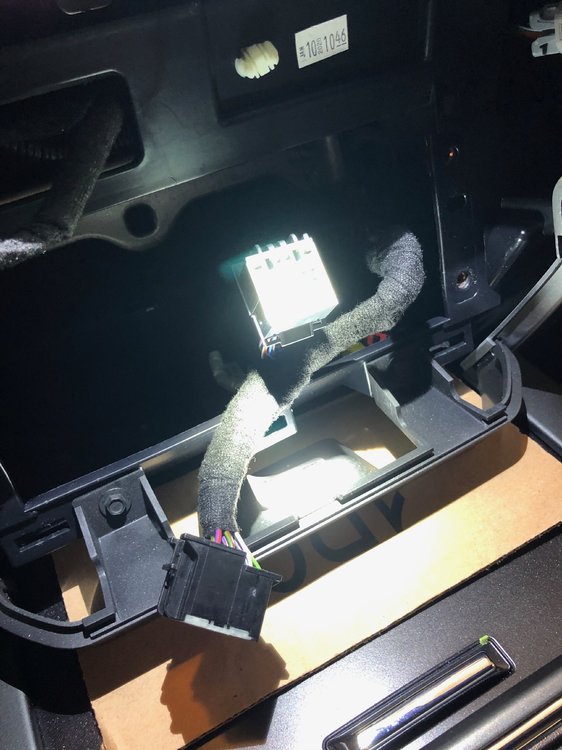

Soldered in, Tessa taped and ready to go.
