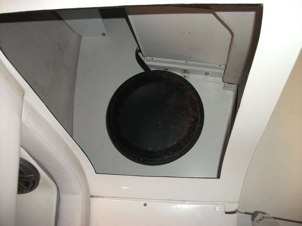

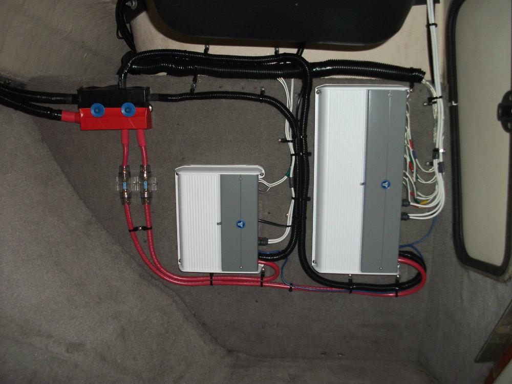

The previous owner installed some nice JL marine grade equipment. M800/8 pushing the JL 6.5's, and a JL M200/2 pushing a JL 13W3V3-2 in a large (3.35 cu ft) sealed box that was installed in the engine compartment. Used all JL wiring for the amps including 1 AWG + and -
WTF???? 200 watts pushing a 600 watt RMS sub. JL recommends a 1.75 cu ft sealed box. And placed the sub in the engine compartment. (that's like putting one under the hood of your car)

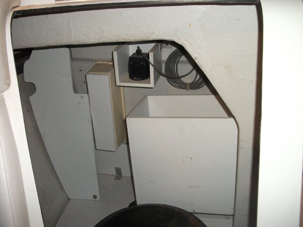

 I have this big waste of space in the boat I would like to use for an enclosure. I just don't know what to do with it. I will have to cut fiberglass to utilize it, and that concerns me. So if i can make a cut as small as possible, that would be best. So my thought is what if I can make a band pass box that will have just the port opening cut out? I know most of you feel the band pass has ran it's course a long time ago. I think it just might be the ticket for me though, and here's why.

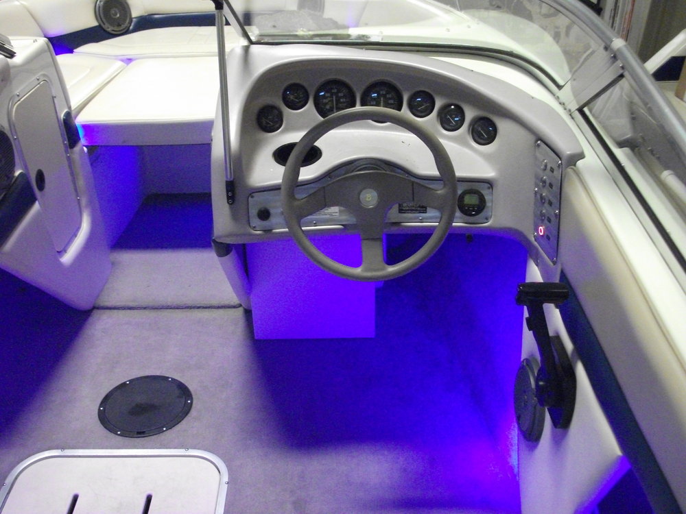

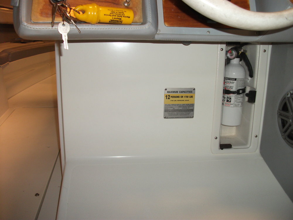

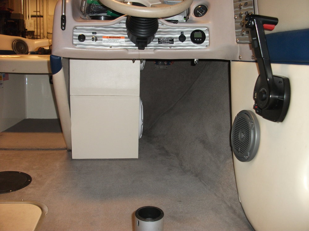

The area of interest in under the helm of my boat in almost a thin/flimsy fiberglass closet. It's not air tight by no means, so an infinite baffle is not ideal. I can attempt to make it air tight, but would then have to cut a large hole in the fiberglass, and back the glass up with a lot of wood to make it strong. I'm thinking a JL M7-12IB if I go this route. A ported box would need too much cutting of fiberglass, or would be shaking the inside of the "closet" and not filling the listening  area. Sealed would be the same as the infinite baffle problem.
Can someone design me a box that might be able to work for this particular application? I have a lot of room, BUT...... it's more long  and tall, not very wide. Meaning the port would need to exit out the side of the box not the normal "face" if you will.

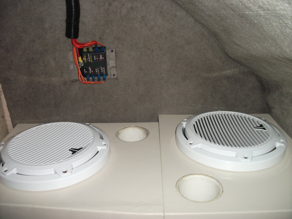

I had 2 JL M5-10W subs in ported boxes that were corner loaded under the helm of my other boat being pushed by a JL M600/1 wasn't really impressed.
