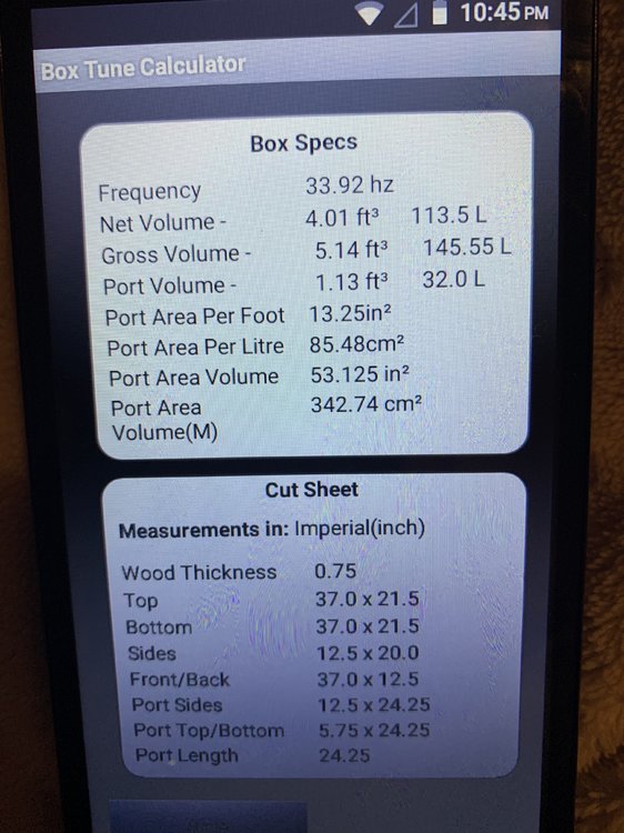

You mean you want somebody to design you a subwoofer enclosure for 2 SA 12s? If so, I got you. First off, what kind of vehicle is it going in and what kind of amp will be pushing the subs?

I thought you had 2 sa 12s? I just designed you an enclosure for 2 sa 12s

Put the port on the front with the subwoofers. Don’t put it in the middle of the subwoofers, put it on one of the far sides. Understand? That’s how I designed it.
