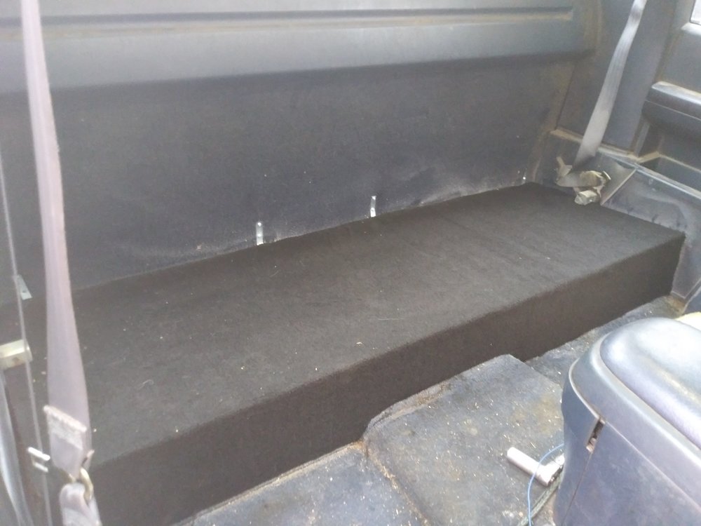

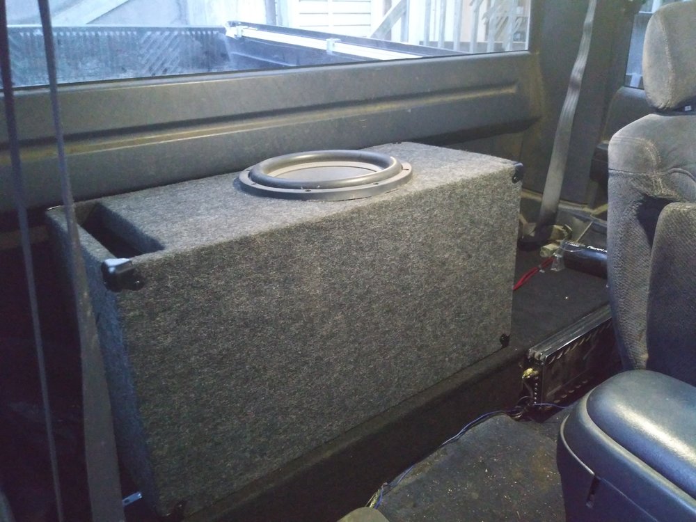

looking for a box design for 2 american bass xfl 12s. i currently have one in a box i built that im not entirely happy with and im looking for help. wanting about 5 cubes tuned to 34 have room but would like to stay around 20hx38wx20d subs up and not sure if should do port up or port side. already removed the seat and built a false floor thank you for any help.

Subs up, port side (Bottom of the side, horizontally)
5 cu ft and 34hz after subwoofer and port displacement
ENCLOSURE
width-34”
height-23”
length/depth-18”
PORT (horizontally on the bottom of the side)
area-66”
length-23”
width-16.5”
height-4”
:guido:
CUT SHEET
Top-34”x16.5”
Bottom-34”x16.5”
Front-34”x23”
Back-34”x23”
Side without port-16.5”x21.5”
Side w/ port-16.5”x17.5”
port-16.5”x22.25”
