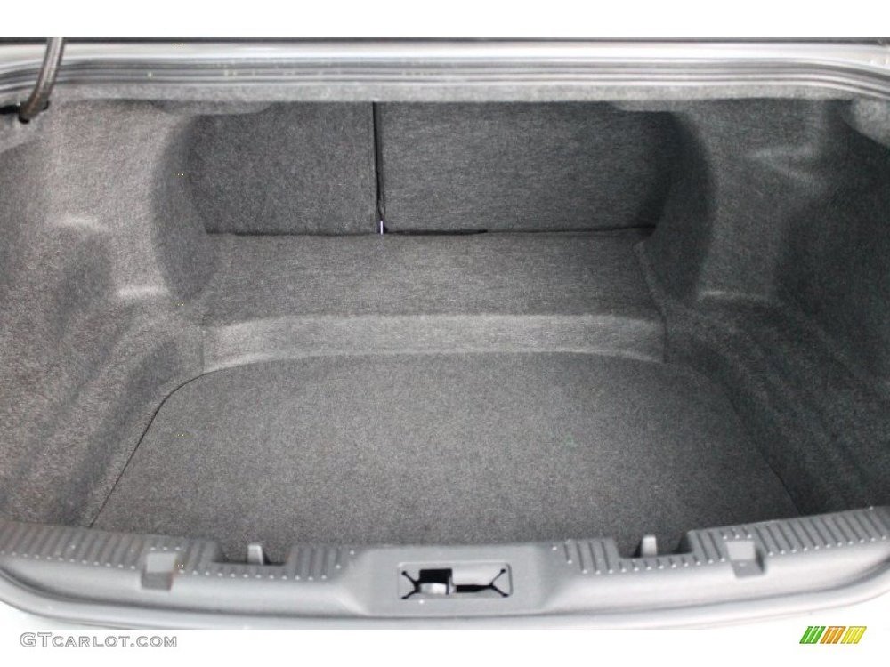

Due to my size limit of 33in long for the full enclosure having a 4in aero port doesn't fit with the sub unless I get creative. And by creative I mean try to do sub up, port side and an interesting box shape. Would sub up, port side be bad in a sedan? Never done that before so no idea how it will sound in comparison.

The port doesn’t have be flush on the enclosure. It can stick out some. As long as it has 4” of clearance from the trunk hatch then you’re good. Don’t worry about it looking weird or whatever. What matters most is what it sounds like. Do sub back, port back. Or do sub forward, port forward and pull the back seat down so it’s firing into the inside of car. Sub forward, port forward with the back seat pulled down is the best for a trunk build.

Unfortunately I can't do that, I can only do sub back, port back for a slot port or sub up, port side for an aero port. My trunk has a rear "shelf" area this is going in because otherwise I lose functional space and I use that space multiple times a week, so not going to be able to move that. As well I don't want to have to put my seats down every time I go to drive the car as I park outside and don't want this exposed all the time.
I don’t understand why you can’t put the port on the same side as the subwoofer and do sub back port back. It’s possible with any application unless it’s like one of them tiny ass hatchback cars that can only run sub up port up. The aero port would just have to stick out of the enclosure. That would be about a 20” port. Or you could up the tuning a bit to like 37 and it would be an 18” port. That would be fine. But if not then just do sub back, port side. Make the enclosure deeper and place the port in the rear side of the enclosure towards the bottom firing towards the drivers side of the trunk.

I can't do sub back, port back with an aero port because I have limited space for the box, in the pic I am putting the box on the "shelf" behind the seats and there is no way I am sticking a port out into the rear section of the trunk.
What enclosure size are you using for that 20in or 18in length? I get 25.72in for a 1cuft box tuned to 35hz with a 4in.
Don’t do sub up port side either unless it’s a last resort. Subtract some inches from the width and add some to the depth and do sub back, port side, drivers side. Aero port. See what you can do with that first. Then try redesigned a slot port build with longer port length and tweak the port some.
