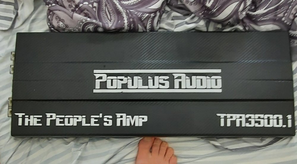

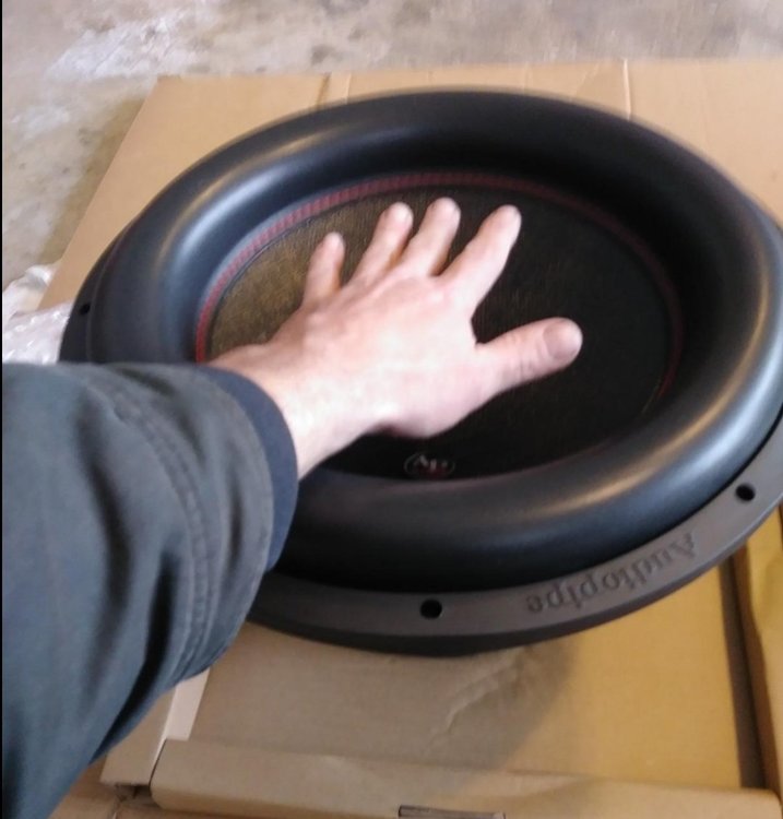

Hey y'all, I'm looking for enclosure design plans for a single Audiopipe TXX-BDC4 15D2 (2800watt), with a 3500watt Populus Audio amp.

That subwoofer CAN’T HANDLE that amp. You would need 2 of them subwoofers, at least, and you would have to send that dual 2 ohm subwoofer back and get 2 dual 4 ohm subwoofers and wire them in parallel to 1 ohm or get 2 dual 1 ohm subwoofers and wire them in series to 1 ohm. And you would have to have the gain set correctly and never past the half way point. Plus with that amp, you need to power it with 2 1/0 awg wires and ground it with 2 1/0 awg wires. You can’t leave any of them power and ground inputs on that amp empty.
