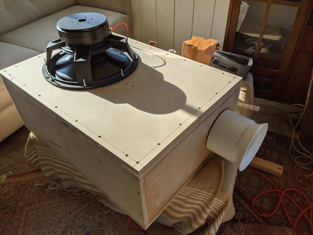

Dang so I would need it to be 30 inches !??! I dont think my box is that long for it to fit.

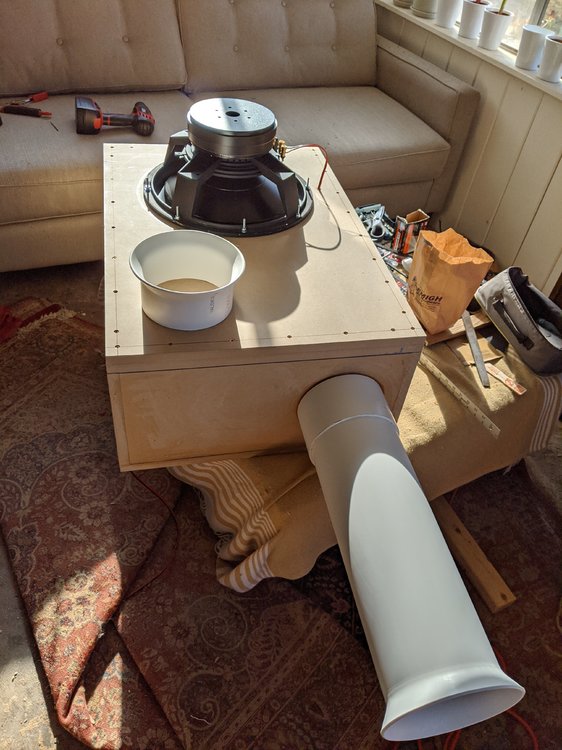

Hey Angel, just so you know, a port doesn't have to fit completely inside the box. It can partly protruding from the box, or completely protruding, with none of the port being inside the box.
Depending on the space you have to work with, you might want some or all of your port to be exposed.
Ah okay, well i was working on mine yesterday and i have it sticking out by like 10 inches
6/7/2020
Tested the system out with the 6 inch port and there is a HUGE difference !
The 4 inch PVC i had on it was restricting it by A LOT !
