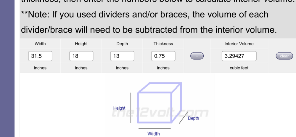

1point21gigawatts Posted June 6, 2020 Report Posted June 6, 2020 sealed section “How can we help you?” “And don’t forget to tell them that the customer isn’t always right.”

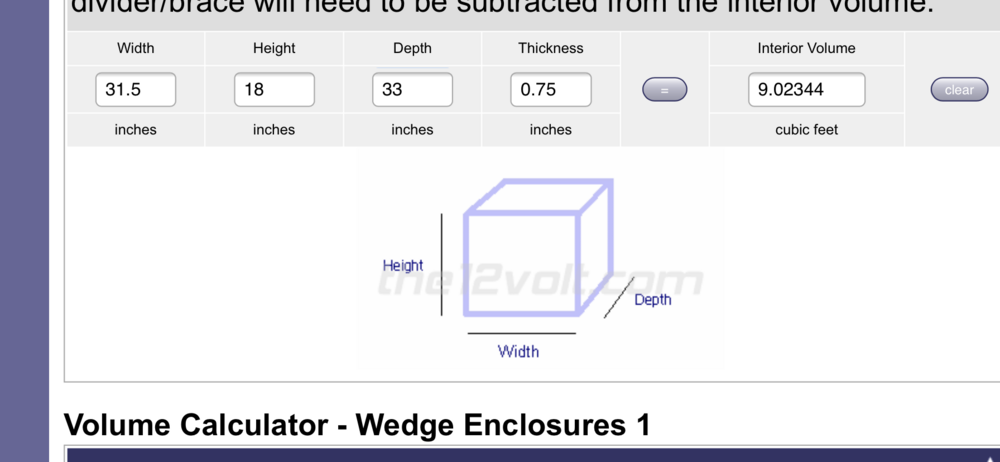

1point21gigawatts Posted June 6, 2020 Report Posted June 6, 2020 ported section “How can we help you?” “And don’t forget to tell them that the customer isn’t always right.”

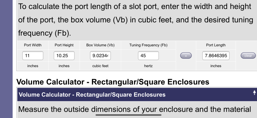

1point21gigawatts Posted June 6, 2020 Report Posted June 6, 2020 port length. Keep in mind to factor in the .75” piece of wood the port is connected to to the port length. “How can we help you?” “And don’t forget to tell them that the customer isn’t always right.”
1point21gigawatts Posted June 6, 2020 Report Posted June 6, 2020 The enclosure will be 46” deep and where they connect creates a double baffle for the subwoofers to be mounted in. “How can we help you?” “And don’t forget to tell them that the customer isn’t always right.”

1point21gigawatts Posted June 6, 2020 Report Posted June 6, 2020 Since the bottom of the enclosure will be missing because it’s a 4th order enclosure that you load the subwoofers from the bottom you will negate .75” from the height bringing the height to 17.25”. All the calculations will still be the same. The floor will just serve as the bottom piece of wood, so to say. “How can we help you?” “And don’t forget to tell them that the customer isn’t always right.”

M007 Posted June 6, 2020 Author Report Posted June 6, 2020 2 minutes ago, 1point21gigawatts said: Since the bottom of the enclosure will be missing because it’s a 4th order enclosure that you load the subwoofers from the bottom you will negate .75” from the height bringing the height to 17.25”. All the calculations will still be the same. The floor will just serve as the bottom piece of wood, so to say. I really can’t thank you enough, man. Anything I can do for ya, please don’t hesitate to ask. You saved me a bunch of time, energy, and money! My box would’ve sounded way off. Lol. Any particular place I should turn to learn more so I can help others? I would like to at least pay it forward...
1point21gigawatts Posted June 6, 2020 Report Posted June 6, 2020 7 minutes ago, 1point21gigawatts said: port length. Keep in mind to factor in the .75” piece of wood the port is connected to to the port length. 7.875” aka 7 7/8” will work for the port length. So since there will be a factor of .75” on the front wall added to the port length, you have to subtract that from 7 7/8”. .75”=3/4=6/8 7 7/8-6/8=7 1/8” in length and connect that to the front wall as an external port. “How can we help you?” “And don’t forget to tell them that the customer isn’t always right.”
1point21gigawatts Posted June 6, 2020 Report Posted June 6, 2020 13 minutes ago, 1point21gigawatts said: port length. Keep in mind to factor in the .75” piece of wood the port is connected to to the port length. The port width and height are inner measurements. The putter measurements are 12.5” width and 11.75” height. Had to factor in the .75”x2 of the pieces of wood to each measurement. “How can we help you?” “And don’t forget to tell them that the customer isn’t always right.”
