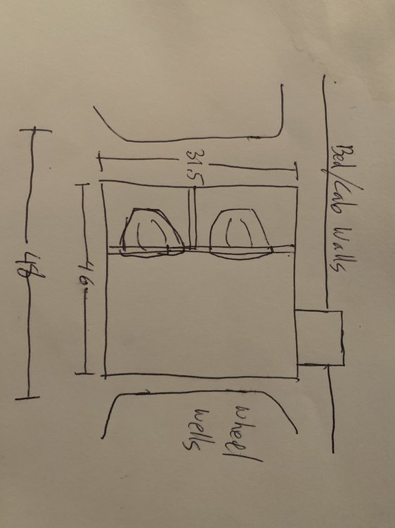

M007 Posted June 6, 2020 Author Report Posted June 6, 2020 2 minutes ago, 1point21gigawatts said: 7.875” aka 7 7/8” will work for the port length. So since there will be a factor of .75” on the front wall added to the port length, you have to subtract that from 7 7/8”. .75”=3/4=6/8 7 7/8-6/8=7 1/8” in length and connect that to the front wall as an external port. Ahhh! I gotcha now. Using the word “connect” helped me see it. I’m a visual person.
1point21gigawatts Posted June 6, 2020 Report Posted June 6, 2020 Can the depth of that enclosure fit, 46”? “How can we help you?” “And don’t forget to tell them that the customer isn’t always right.”
M007 Posted June 6, 2020 Author Report Posted June 6, 2020 6 minutes ago, 1point21gigawatts said: Can the depth of that enclosure fit, 46”? Oh yea. That’s fine. Pretty dang perfect really. It’ll fit between the wheel wells even with rhino liner on it so I can slide it in and out if it needs service. I’ve got External enclosure limits of 20” H 48” Wide(or deep depending on orientation) 70” Deep(or wide, “)

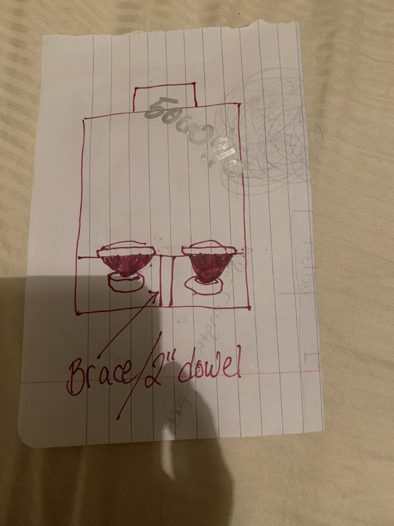

1point21gigawatts Posted June 6, 2020 Report Posted June 6, 2020 Placement of bracing “How can we help you?” “And don’t forget to tell them that the customer isn’t always right.”
M007 Posted June 6, 2020 Author Report Posted June 6, 2020 7 minutes ago, 1point21gigawatts said: Placement of bracing Thanks for the visual. Could it also work like this, to maximize usable bed area? Would it change the way it sounds?
1point21gigawatts Posted June 6, 2020 Report Posted June 6, 2020 4 minutes ago, M007 said: Thanks for the visual. Could it also work like this, to maximize usable bed area? Would it change the way it sounds? There’s no way to position it where the port is firing forward like in the diagram I posted? “How can we help you?” “And don’t forget to tell them that the customer isn’t always right.”
1point21gigawatts Posted June 6, 2020 Report Posted June 6, 2020 25 minutes ago, M007 said: Oh yea. That’s fine. Pretty dang perfect really. It’ll fit between the wheel wells even with rhino liner on it so I can slide it in and out if it needs service. I’ve got External enclosure limits of 20” H 48” Wide(or deep depending on orientation) 70” Deep(or wide, “) “How can we help you?” “And don’t forget to tell them that the customer isn’t always right.”
M007 Posted June 6, 2020 Author Report Posted June 6, 2020 2 minutes ago, 1point21gigawatts said: There’s no way to position it where the port is firing forward like in the diagram I posted? Yes, there is. I just give up a little bed area towards the tailgate but gain more on the sides of the enclosure. No big deal. I’m just a visual dude and was getting my depths and widths backwards or something. Lol.
1point21gigawatts Posted June 6, 2020 Report Posted June 6, 2020 6 minutes ago, M007 said: Thanks for the visual. Could it also work like this, to maximize usable bed area? Would it change the way it sounds? That’s gonna disrupt the air flow, thus lessening the output and affecting the overall sound. “How can we help you?” “And don’t forget to tell them that the customer isn’t always right.”
1point21gigawatts Posted June 6, 2020 Report Posted June 6, 2020 1 minute ago, M007 said: Yes, there is. I just give up a little bed area towards the tailgate but gain more on the sides of the enclosure. No big deal. Go with the idea I posted. Port on the front wall firing forwards. That’s the best way. “How can we help you?” “And don’t forget to tell them that the customer isn’t always right.”
