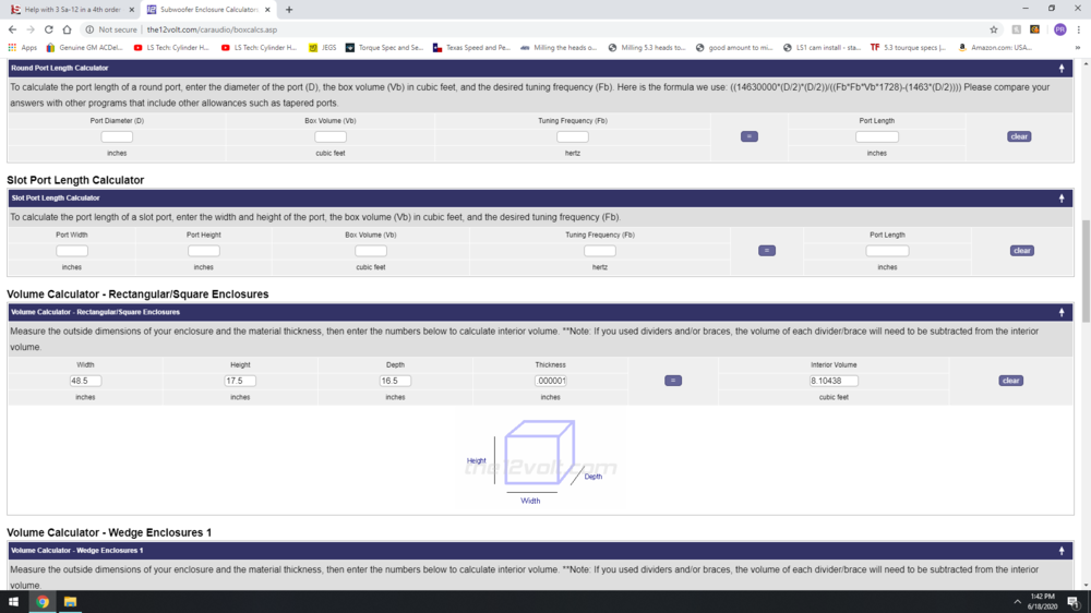

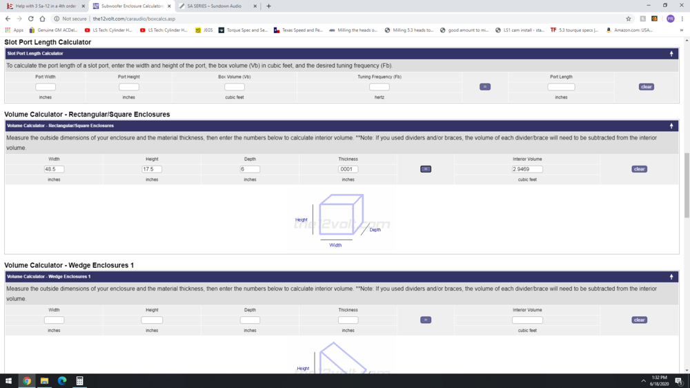

On my current box it has .8 sealed each chamber (can i remove the walls to have all 3 share one big chamber or does it have to be each to their own chamber?). And 5.30 after displacement (each sub has .15) it gets 5cuft.  I need the box to be 50" wide, 19" tall and no more than 29" long on the outside measurements. Here are my new box specs not sure if i did them correctly. I just need help with the port. Thanks let me know what you think. This box will be 50" wide, 19" tall and 24" long on the outside measurement.

Ok, lets assume you are going to go up to ~2.4 cu ft on the sealed side and ~7.5 cu ft on the ported side. With 3K of input power and a 45 hz tuning I would use no less than 120 sq in of port area.
As far as your sealed chamber goes, you certainly can have all three subs in the same chamber.  One advantage to doing separate chambers for them though would be if you blow one sub your other two subs won't suddenly experience 50% more sealed volume, which could cause them to fail as well.  Its not a huge deal though.
