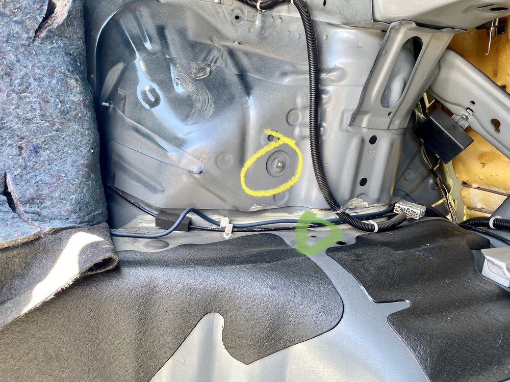

3 hours ago, DankMan said:
I can put my main ground there
Take another picture of this location but further back so I can see more
:guido:

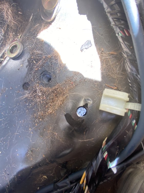

4 hours ago, DankMan said:
@1point21gigawatts would that be a good ground spot? I could ground my amp there..
NUT AND BOLT IT RIGHT THERE. TO DO SO, YOU SEE THAT BIGGER HOLE BESIDE IT NEAR THAT DARK GREY RUBBER LOOKING SHIT ALL OVER THE FLOOR? CUT A BIG ASS CIRCLE TOWARDS THAT RUBBER SHIT AMD USE THAT BIG HOLE AS A STARTING POINT. THEN YOU CAN STICK YOUR HAND WITH A WRENCH IN THERE AND BE ABLE TO NUT AND BOLT IN THAT LITTLE HOLE I CIRCLED. I KNOW IT SEEMS LAME TO CUT AT YOUR VEHICLE BUT MOST ALL OF US HAVE DONE SO AND THATS WHAT HAS TO BE DONE SOMETIMES WHEN IT COMES TO CAR AUDIO. PLUS, YOU CAN REUSE THAT SAME GROUND SPOT. THAT SPOT YOU CIRCLED WINT BE THAT GOOD OF A GROUND BECAUSE THAT PIECE OF METAL WELDED THAT MAKE THAT SPOT STICK UP. ITS BEST TO GROUND TO A FLAT SPOT.

Even though that spot I circled is like a hump, it’s straight. You see where the hole flares a little bit? Use a hammer and a piece of flat metal to set on top of that spot and hit with that hammer to flatten the flare out and get it straight and flush and symmetrical as possible. Don’t bang in the hump though just carefully flatten the flare and make the hole flat and symmetrical on the hump. Post that picture I wanna see too.
I looked at that closer and it’s a piece of metal on top of the chassis. Bad spot. But still post a better picture so I can see more of the surrounding area.
