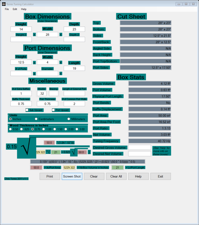

I just made a box and it is terrible. I originally thought tuning it at around 41 would be alright but when listening to my playlist the lower notes barely hit and when a 40hz tone plays it absolutely smashes.
So I plan on remaking the box, this is for two American bass XR or XFL 10's d4s(pretty much the same thing). Running it on a taramps smart 3.
I plan on tuning it way lower at 33-34hz. The American Bass website calls for 1.25-1.5 cubes per sub, I've met that at 3cuft. Other people seem to go with a lot more. Should I give them as much volume as possible? My trunk space is limited but I think I could get up to 3.5cuft net.
Also, I put a double baffle on this one and it was such a pain in the ass to get perfect/cut through. You guys think I'll be fine with a standard .75in baffle?
This is the box I've already made
