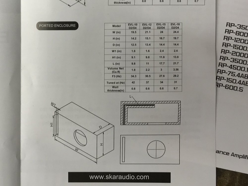

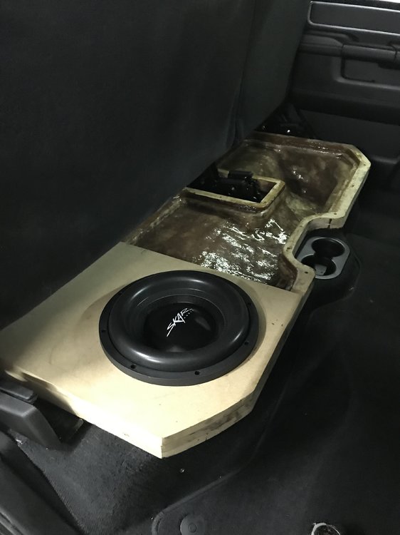

Looking for eveyone's opinion on the port size for a EVL-12 on RP-1500 in a 2 Net cu ft fiberglass box.   ~35Hz
The speaker manual recommends a 15 sq in port area.

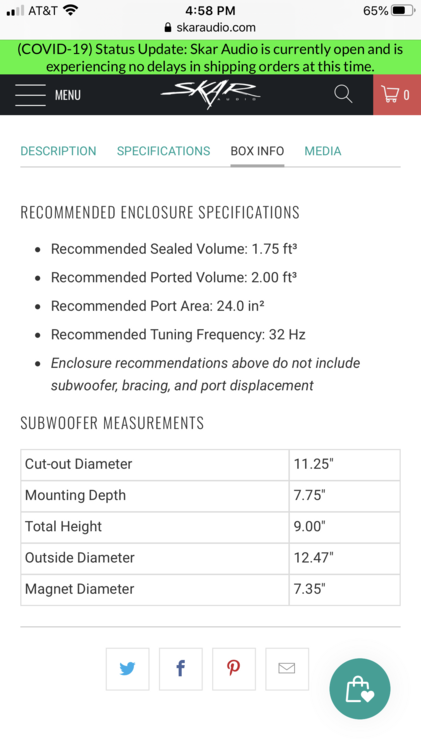

Online Specs recommends a 24 sq in area
Most post calcs and forums recommend 15 sq in min / sq ft.
I’m not sure on the port size but nice build work!! I’m fighting the itch to go with 1 more 12!
