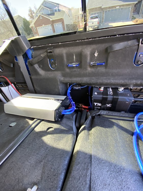

Changing the system from 1 12” to 2!
I want some sort of install medal!

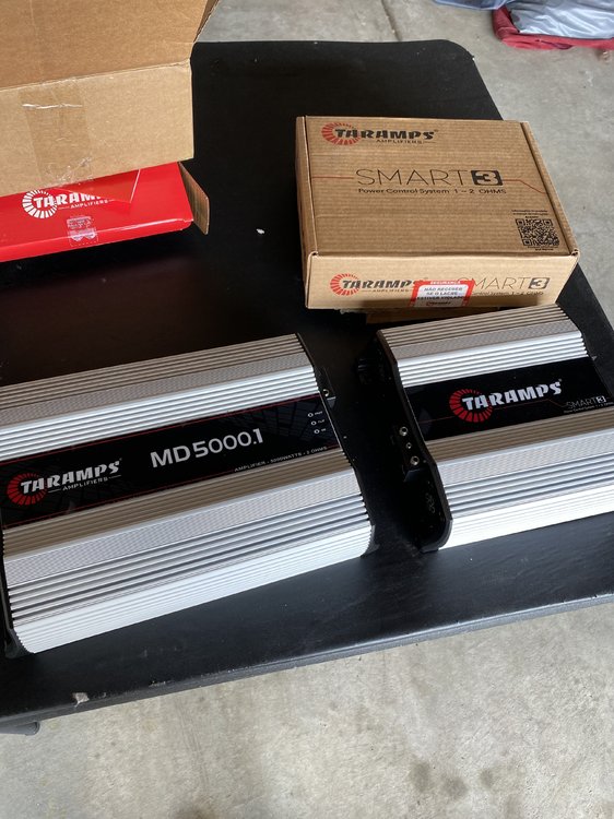

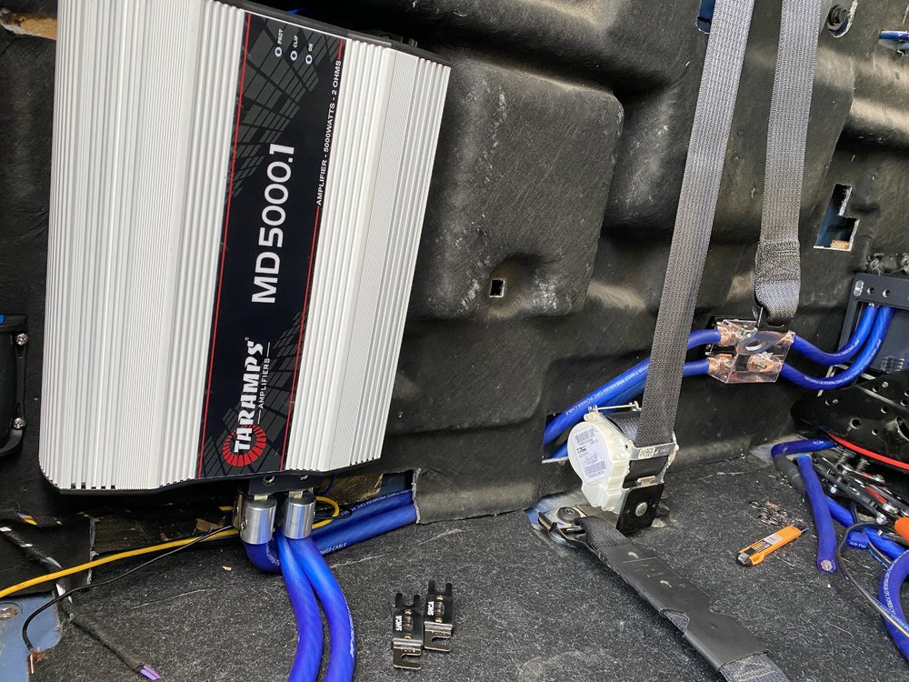

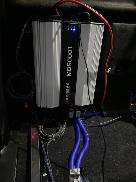

Well here she is, only 1 sub still, now @ 4ohm until my dual enclosure comes.... still capable of 3200w so I’m sitting with more than the smart 3 had. Damn hurricanes holding up production

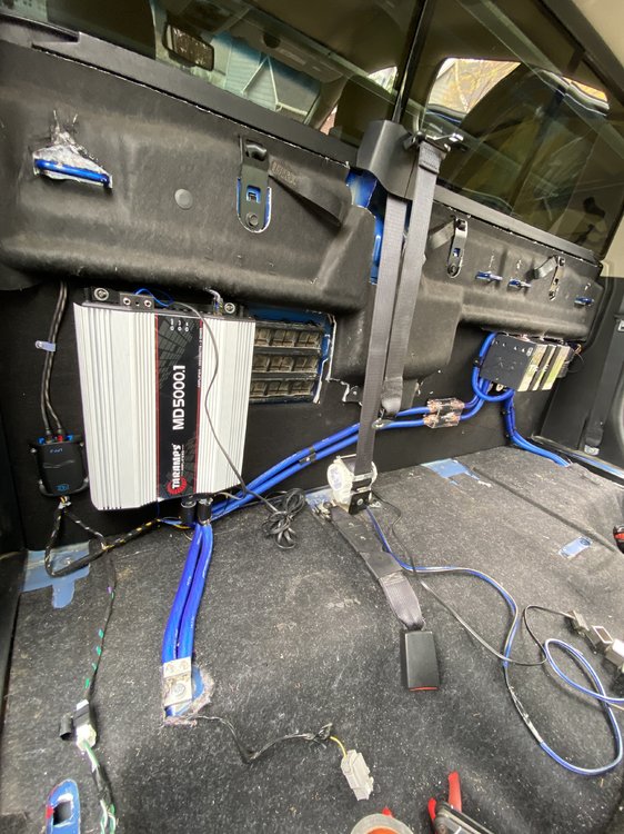

Why purchase a full wall amp rack when you can build one yourself?

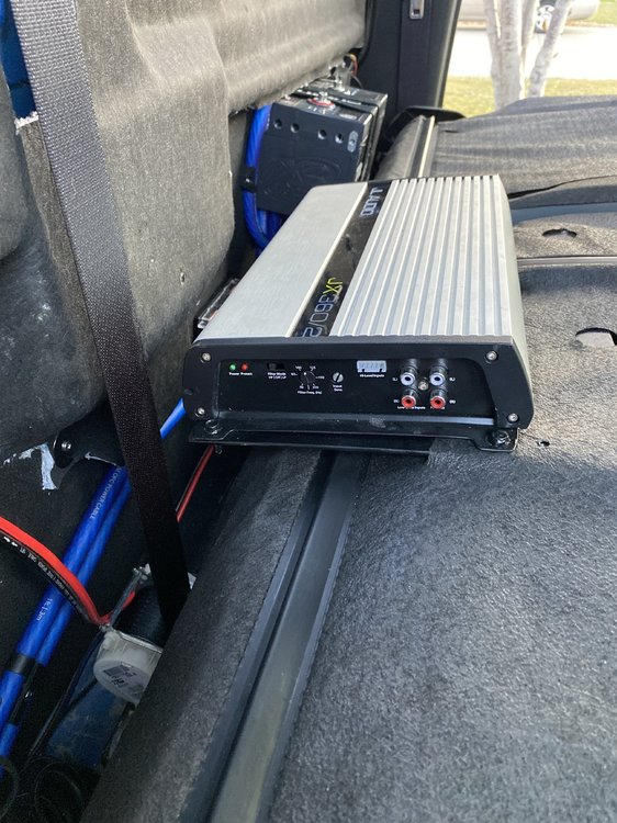

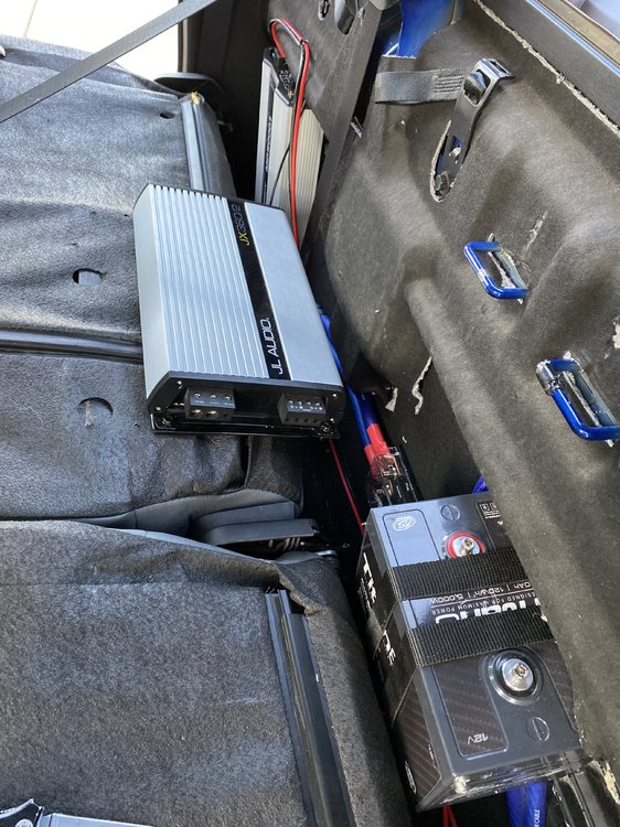

Added a jl 360/2 for the 4 doors. Should be decent, 90rms @ 2 ohm per speaker.  Thanks to 1point2giga
If anyone is giving away any 6.5s let me know 😜

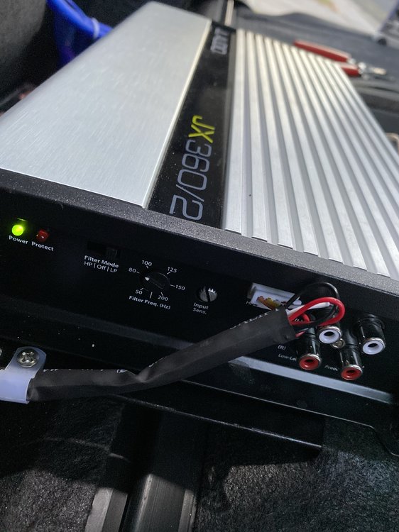

When companies want upwards of $100, some $200 for a t-harness to plug in behind the head unit to give you signal for the amp... you buy the $5 high level plug and tap the rears to get your own! #rcas are for noobs haha

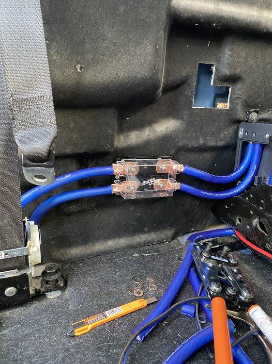

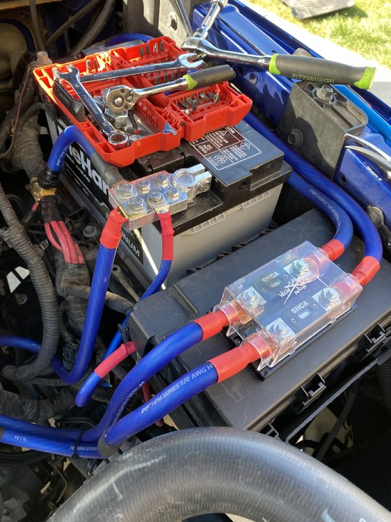

Days off.... keep idle hands busy. Figured an additional run to the lithium can’t hurt.

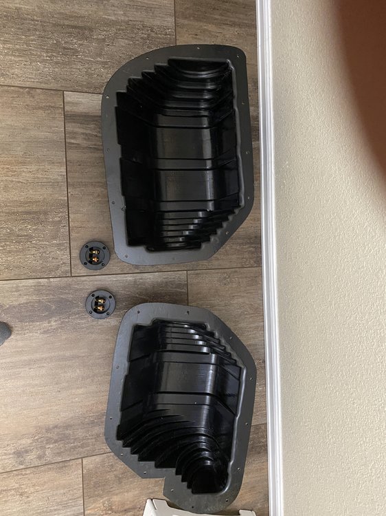

Wish they’d tape the 2 separate boxes together.... so the upper enclosure would arrive with the bottoms 😂 can’t use 1 without the other! Even upgraded the terminals for free. Although I’m using Dayton gold binding posts
