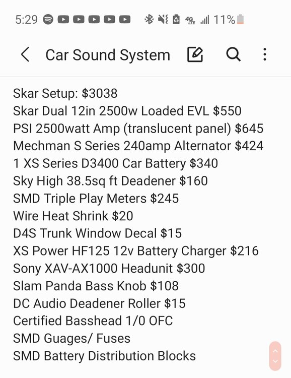

Im pretty new to the car audio world and Im currently specing out my system and need some suggestions. I was going to go with 2 psi platform 3s but the budget was getting to high so I went with the Skar Evl dual 12s. I have a question about the amplifiers though. This psi amp only has 1 speaker input, am I still able to put 2 subs into it by doing a parallel connection? Lastly, when I upgrade the mids/ highs, do I need another amp with multichannels?

My personal opinion, a 5000 watt amp will be too much for those subs. That's just my opinion. I've never owned those subs, so that's just my opinion. I don't know for sure. I'm not going to tell you what to do with your build brotha
Maybe if you run those subs at 2 ohm you won't have problems. But if you run those subs at 1 ohm, amp gain set to right before clipping (where it's supposed to be) I think it'll blow those subs. Also, you might want a little more electrical to support the 5k power. You don't want your voltage to drop to low. That's bad for your batteries and bad for your equipment

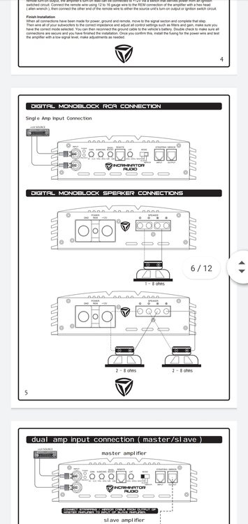

I may power those at 2ohms impedence with the 5k. Im upgrading everything electrical too. But I was also wondering if the Incriminator IA20.1 2800w would work also. The only problem is that in the manual it shows that when you hook up 2 subs that the impedance is rated at 2ohms. I wonder how I could get them to go to 1ohm
