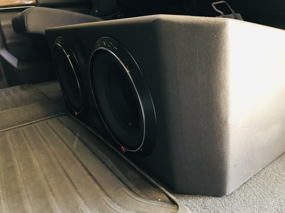

2019 Chevrolet Silverado Crew Cab RST and Rockford Fosgate
Rockford Fosgate Gear:
Punch series P2D4-8
Punch series P500X1bd mono block
Enclosure: Custom Ported Wedge 24.0”W x 13.25D x 10.675”T1/7.0”T2 @ 10CuFt and two 2” dia. x 8”L ports
Two 8” 4ohm DVC RF Punch subs wired Parallel/Parallel resulting in 1ohm load
