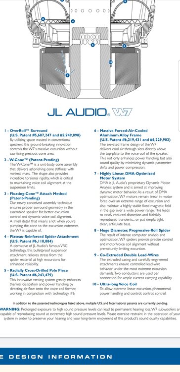

Dafaseles Posted February 12, 2021 Report Posted February 12, 2021 There's a lot different. https://www.jlaudio.com/collections/car-audio-subwoofers-w7ae You can start by reading JL's description alone on the w7. Has some insight. And here's a picture of some of the patients info. 2011 Chevy Silverado under construction My build log here. Check it out!
