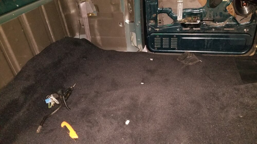

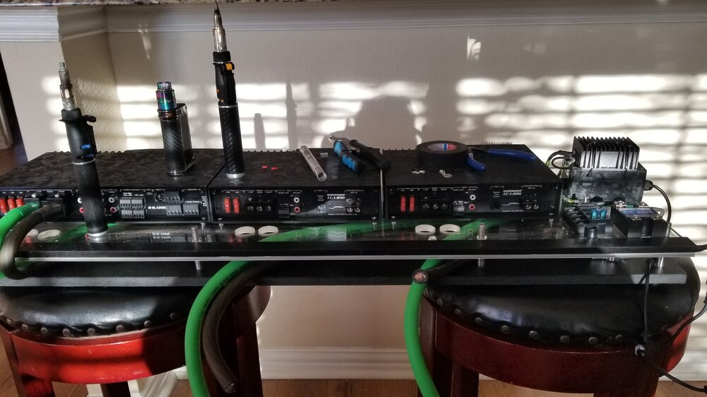

My Truck cab is " HxWxL" 5.8 x 6.2 x 6.5 feet my back seat folds down and that's where im placing every thing. the seat folded down is 28" deep x 60" wide. I plan  to put the box's and amp rack on it ..attached is my amp rack that space from the door back is the area for my subs n Amp :) ..
