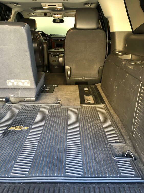

What is a little unknown is how the subs will sound/perform in the designated space.  I intend to leave in half of the 3rd row, orienting the box from behind the passenger side 2nd row seat back to the liftgate.  Looking to do subs up and port back about 8 inches from the liftgate.  Space dimensions are 49"X24.5"X24" h (or whatever height is ideal).  Since it is for daily use, I want it to sound good anywhere in the vehicle but I'm fine if the corner port situation has it sounding best at the driver's seat.
I know it's my first post and am not expecting tons of "help" with ideas but any and all opinions and perspective are welcome.  I am interested in seeing how this box orientation sounds and will go from there.  I am not optimizing the 2500.1 amp very well with the subs being D2 ohm.
