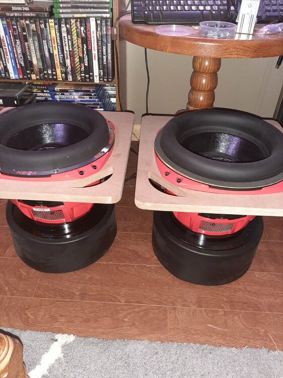

Where to begin....I recently purchased a pair of orion 12" HCCA SPLX subs (7.5kw RMS each) and an Orion 17000.1D SPLX amplifier to push them. I have one 350a alternator in the car now, and one more yet to be installed once I finish making the bracket. As of right now it won't be a competition car, but someday....probably.
