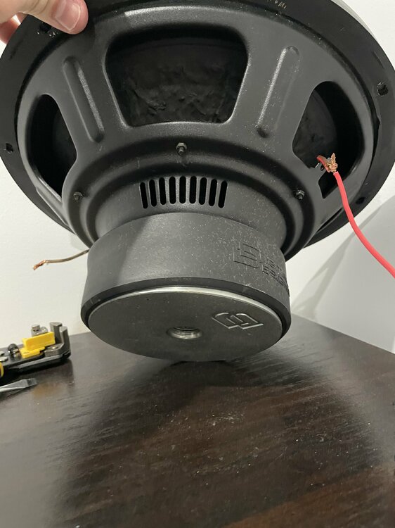

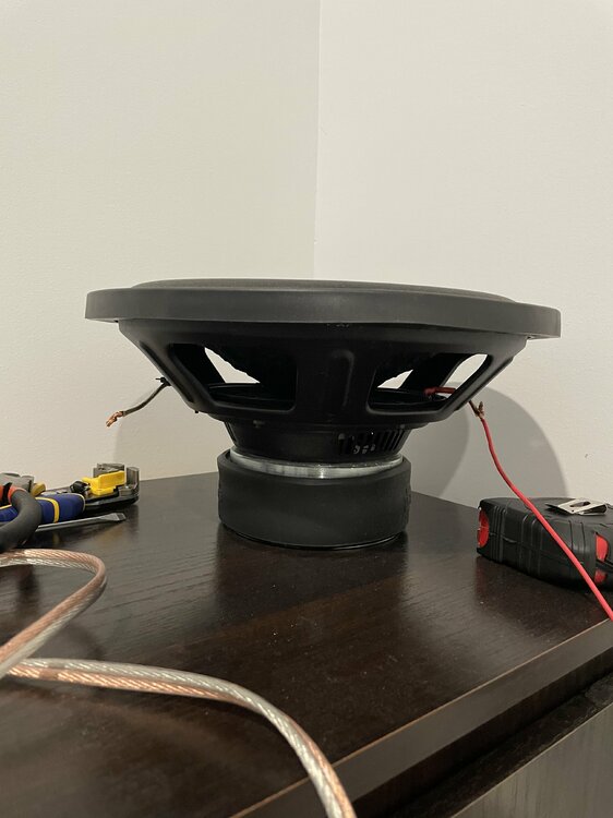

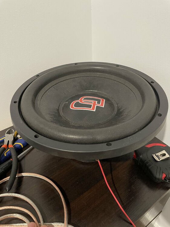

Hey brains trust,
I just came across this sub on a very good deal .
I have a monoblock amp to run it off, hoping to run at 2ohms.
but I don’t know to much about this sub. Would anyone know the model number by looking at photos ?
or can you tell me how to run it at 2ohms if possible ?
noticed it doesn’t really have a DVC set up (could be wrong) is this needed for two ohms  or if I just use the positive and neg that it currently has would that be at 4 or 2 ohms (as you can see I’m a newbie to the ohms side of things)
send help any info would be much appreciated
6 hours ago, liteblue said:
It looks like single voice coil. Hook up a dmm set to ohms that will tell you if it is 2 ohms. I suspect it is 4 ohms.
Bugger that is what I thought. Is their any way to get it to 2 ohms if it reads as 4?
Not without rebuilding the woofer with a 2 ohm voice coil. Which would defeat the good deal you got.
What amplifier you plan on pushing it with? I would still hook it up! You could be pleasantly surprised.
