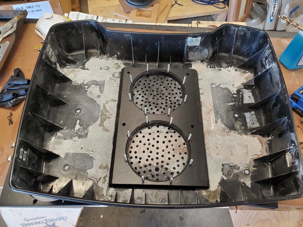

I started off by filling all the low spots in the trunk with Bondo-hair and punching a bunch of holes to make a moc-grill on the bottom of the trunk (in an attempt to protect the cones from the elements as much as I could)  The sub mounting plate is 3/4 inch expanded PVC bolted to the trunk bottom with the mounting bolts for the subs epoxied in place
Curing some glass laid up with SunFlash to try and strengthen the trunk bottom

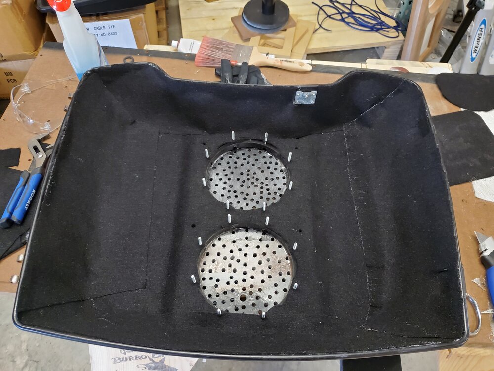

So I didn't have any carpet and the shop that asked me to take a crack at the build only had scraps that I had to piece together.  It didn't look as crap in person, but it still didn't look good

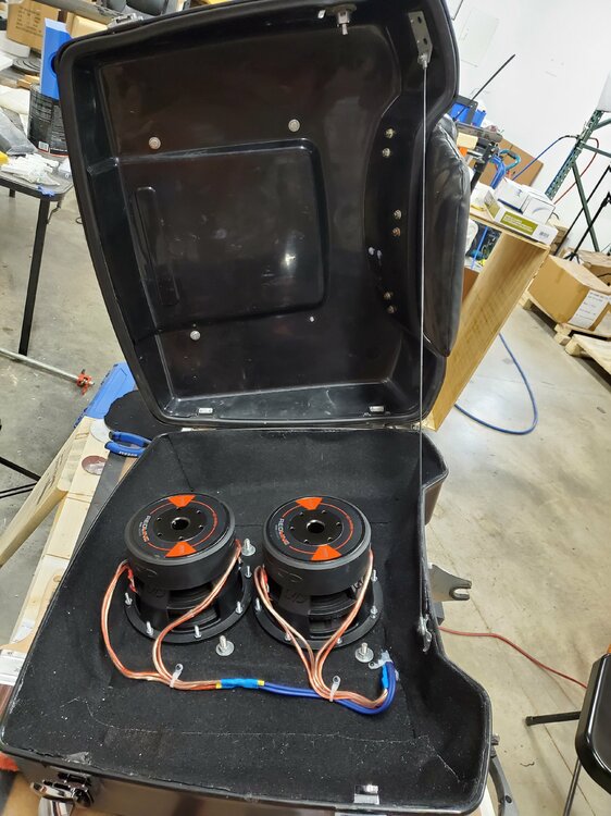

Subs in and some replacement latches.  I ran the speaker leads down and soldered them to a set of XT60 connectors.

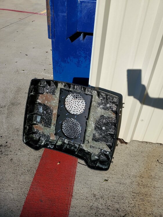

So it didn't look horrid, but it didn't look very good either.  The worst part though, is that on the bike, the 3/4" expanded PVC mount plate broke down and failed mechanically within a month.
