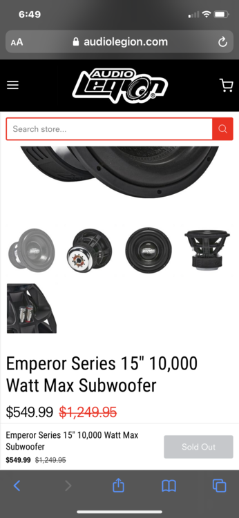

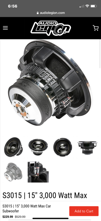

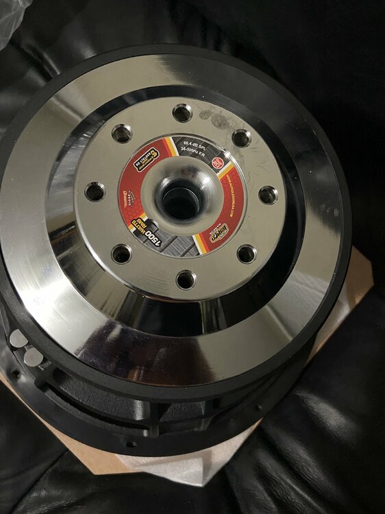

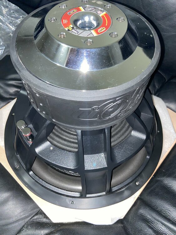

S3015 v1 is the model on the box. Can't find a manual or specs anywhere. I was supposed to get a different looking sub. Audio Legion is not answering phones or replying to emails. First pic is what I ordered. Second pic is what looks like what I got but not exact. Idk what to do.

So if you don't have any luck finding the T/S parameters anywhere, they can be measured using an SMD IM-SG+ or a Dayton Audio DATs system.  Any chance you have or know somebody that has one of those tools?  If not, you might be able to call around to some shops in your area to see if they may have one of them and can measure out the sub for a small fee.
If you go the measuring route, it would probably worth working to break in the sub for a good 10-20 hours before measuring it to break in the soft parts and get a more accurate measurement.
If measuring the sub params isn't an option, maybe build an enclosure based on parameters of the closest Skar sub you can find and go from there.
