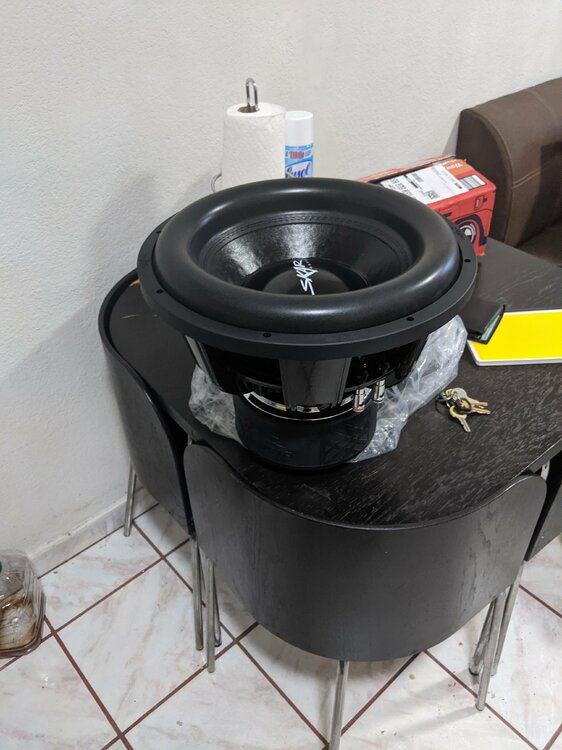

Trolluken99 Posted December 5, 2021 Report Posted December 5, 2021 Good afternoon people, I need your help, I'll put 2 ZVX15V2 subwoofers but I want to make my own box. What kind of box do you recommend and what measurements is it for a 2011 Ford Edge?
Joe X Posted December 6, 2021 Report Posted December 6, 2021 I would recommend you a ported box (subs up / port back) 8 cubes net tuned to lower 30s and some 120 square inches of port area on rated power, without trunk dimensions, amp being used I can't be more specific.
