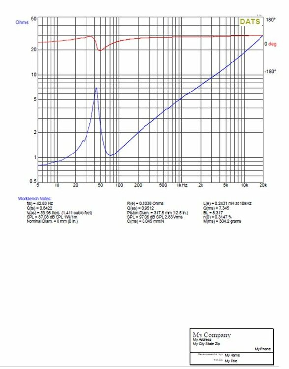

Your measured parameters seem to suggest your sub is not broken in yet, likely not the best for modeling right now.
Since the manufacturer is giving you parameters, is there a reason you decided to measure yourself?
The sub i bought, and the sub i got from Audio Legion are two different subs. A few different people in another post i made said its a different version of what they published online. Thank you for your time btw.  Much appreciated.

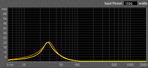

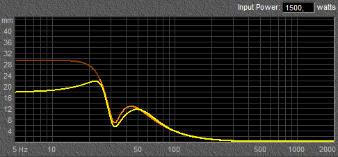

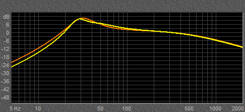

Below is a comparison between your DATS parameters (yellow) and the online specs of the S3015v1 (orange) using their box suggestion:
 4 net @ 32Hz. port: 44sqin, Cabin Gain Model: +12dB/octave 50Hz, input power: 1500WRMS.
Normalized amplitude response:
Cone excursion:
Port Airspeed:
So from the plots above you can see that your sub as measured can perfectly work with their box suggestion to rated power:

Now for the science I would DATS the sub after the break in period just to see how parameters changed.
Ok, thank you, i will look it over and proceed that way. It might be a couple weeks before i can get this done. I will follow up when i have completed the break in and when i have the new parameters. Thanks for the guidance.
