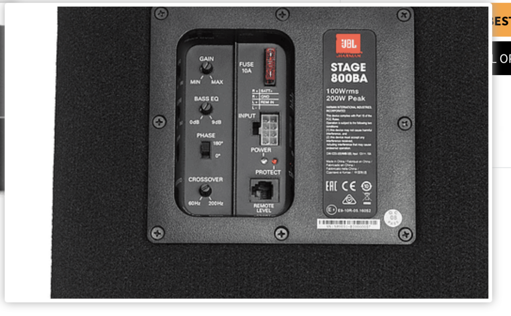

startingboom21 Posted February 8, 2022 Report Posted February 8, 2022 i have found this sub online recently and I wanted to use it indoors. but that connector looks very similar to one of those connectors on pc power supplies, so my question is can this be powered by a pc power supply? or would I need something else? im all new to car audio subs and amps so help would be greatly appreciated
Joe X Posted February 9, 2022 Report Posted February 9, 2022 Any source that can provide 12-14V DC and 15-30A, say this: https://www.amazon.com/Pyramid-Heavy-Switching-Supply-4-5in/dp/B07D4BDDK2/ And to your question a PC power supply of the same current handling can be used but since it's locked to 12V you may or may not get the full output of the sub.
