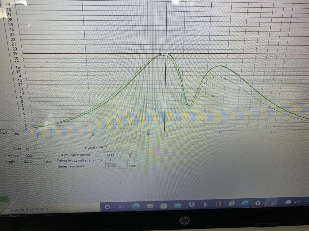

Currently using a single sa12v2 on a skar rp1500.
just ordered a salt 3 for it but now wondering if that was a bad idea and I should have stuck with the salt 2. I plugged the numbers in winisd and my port velocity is high unless I have a big port. Can someone help me run the numbers.

Assuming you are running the SA12v2 at 2 ohm the SALT3 amp would deliver 1500W to the sub, if such is the case:
With your port area of 30.25 square inches you would get about 25 m/s of vent airspeed in a 2@32hz box which is acceptable.
I think you are ok unless you were running the sub at 1 ohm, in that case you just limit the gain of the amp, worst thing that can happen is that the amp runs cooler. So again not a problem there either.

Yes I’m planning to wire to 1ohm. But when I plug in the numbers to say input of 3000 watts the port velocity goes above 40ms.
I may try and switch my order out to the salt 2. I could make my port bigger but not sure what affect it would have on Sound.
 Box would be 2 cubes with 49 sq inches of port (7x7 port)

I just switched my order to a salt 2. With an input of 2000 watts and making the port 6x6 it keeps the ms at 33 max

I added hpf into each box. 2 cubes tuned to 33hz.
both boxes port velocity stay under 32ms.
I added a hpf to each box to keep them in check, I get more cone excursion from the 3000watts input.
think that would be ok?

If you have chosen to source 2K your current box will be fine (despite winisd) and as you say one needs to engage the subsonic filter to limit excursion below tuning and that's all good.
I think though that your upgrade is really going to be on the light side (< 2 dB) but let us know how it went.

I’m calling tomorrow to talk to them about maybe going back to the 3k. I can use the same box and change the port as it’s external to a 6x6 port. With the proper hpf I can keep cone excursion in check and port velocity down
