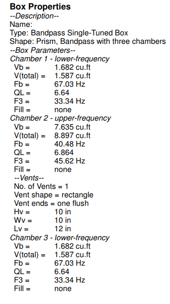

You need to enable cabin gain simulation or you are going to get that super high F3 listed in BBP6.
Being the program setup incorrectly it's telling you that your bandwidth is 33.3Hz to 45.6Hz or about 12 Hz.

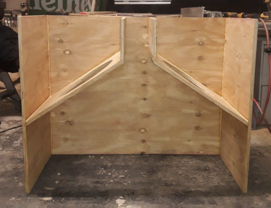

Yeah that is what I realized, once I enable the car cabin gain the bandwidth increases greatly.....by the way we tweaked this a bit and now its playing pretty dang good...
