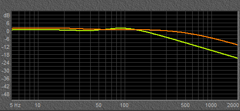

What makes me believe there is something going on with your particular units is that the manufacturer provided parameters model very similar to other drivers in the same box, here is a comparison with a DC Audio level 3 12 (the yellow plot and yours in red) in the same box size (sealed 1.2 cubic feet) and inside a car:
As you can see they work very similar.
So to me the real test is trying a different driver in your vehicle and box and see if it fixes the problem you are experiencing or not.
